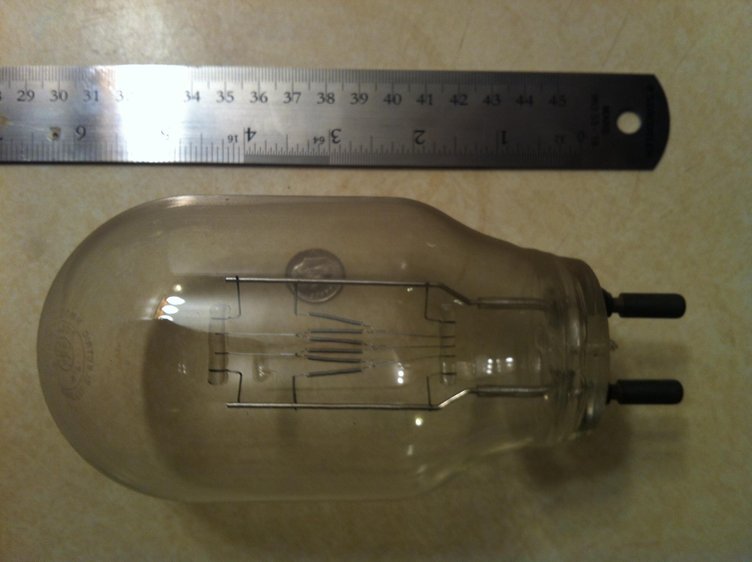

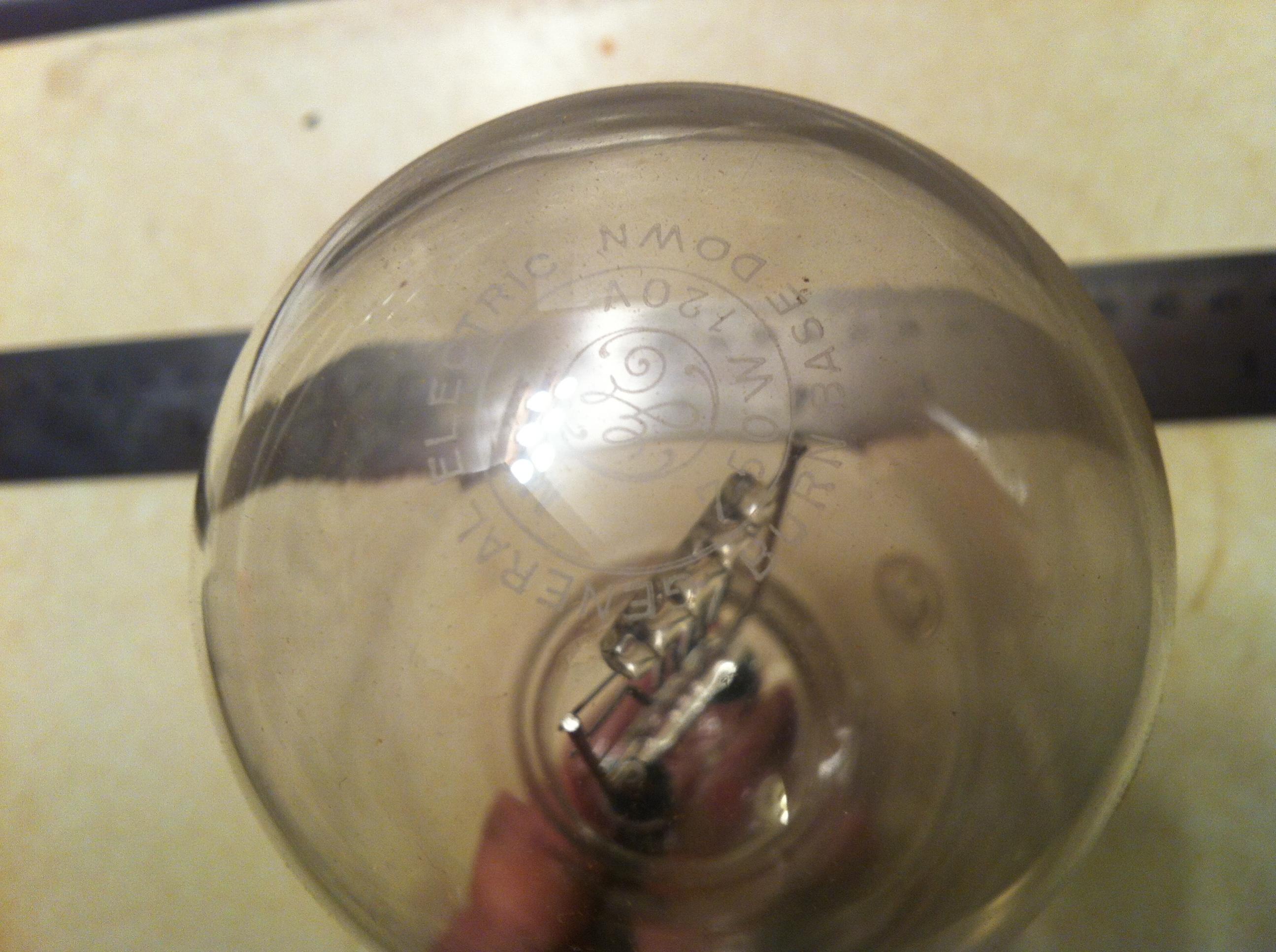

I bought 3 old style Bardwell & McAlister fresnel spots with stands barn doors, snoots, focusing spots, the works from a guy on Craigslist. The lights I was told were made in the 50's and 60's. Also included were a box of 30 750W lamps like the ones shown in the photo. However, other than the standard markings on the lamp I can't find a size or model. Can anyone fill in some gaps for me?
Thanks
Shootar401
Feb 25, 2012
399
New England
Found it! Looks like when they are available as NOS they sell for $200-$250 each!
http://www.donsbulbs.com/cgi-bin/r/b.pl/edg|120v|750w|g22~ansi.html
Looks like they haven't been made in decades. I'm glad I have a few cases of them. Are the quartz lamps of the same spec. a drop in replacement? Will the light quality suffer with the quartz lamps?

A projector bulb
Nelson
Jan 7, 2012
34
East Jordan,
I'd look for a tungsten halogen (quartz) replacement. Off the top of my head I don't know what specific lamp would be suitable, but I'm sure you can find something. If not, post a note at controlbooth.com. I'm using halogen lamps in all of our old stage lights where I work and they work well. Light output from a tungsten halogen lamp will be superior to that of the incandescent lamps that you have now.
When looking for a comparable halogen lamp, compare the base (yours are either medium bi-pin or mogul bi-pin, I'm not quite sure), light center length (distance between filament and lamp base), and wattage (750W or less). I'm honestly not sure exactly how to measure light center length (LCL) on a bi-pin lamp, but donsbulbs probably explains it. Hope that helps!
