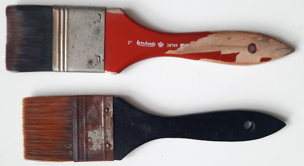

Most of the time I use a synthetic spalter brush, 2" wide. My favorite is a Leonhardy type 20709.
Pictured below it is a ridiculously cheap knock-off which cost me all of €1. It does a reasonably OK job, especially considering the price, and if it's all I had, I could get by with it. But it's a little on the stiff side, and it doesn't contract as nicely in a single hairline as the Leonhardy brush. Btw, the brush at the top cost me something like €15. A quick online search shows me it still sells here in Europe for €17 - €20.
I also have some coarse pig-hair spalters that I use for misc purposes, such as remjet removal on ECN2 film. They can be used for coating things like cyanotype as well, but they produce a rather coarse coating - which some people may like, but I don't care for it. I like a little more precision and the pictured Leonhardy gives that.
The main things I look for in a brush are flexibility of the hairs (synthetic is hard to beat and things get very expensive if you go all natural), how well the hairs concentrate into a single tip/line when you wet them (cheap brushes tend to 'split' or have wayward hairs sticking out) and how well the hairs are attached to the handle (cheaper brushes easily shed hairs esp. when doing 'sticky' processes like gum).

One of the things I’ve always read is to avoid metal ferrules since they can rust and react with the sensitizer, but I’m noticing a lot of folks use brushes with metal ferrules and don’t seem to be complaining!
[edit] heh just ran into a post of yours from 2020 saying that the gripes about metal ferrules wasn’t warranted.
It's correct that those metal ferrules do corrode, and the cheaper brushes tend to be worse in that respect. Note the difference between the two I've shown. The one on the top looks pretty much A-OK despite years of use with aggressive sensitizers of several types. The cheap brush at the bottom has started to rust pretty badly, so I might have to replace it one day. The discounted annual cost for the brush will be something around €0.15 on a yearly basis, or just a little over €0.01 per month. For the more expensive brush, it'll be something like €0.10-0.20/month based on retail price and its life expectancy. If you're looking to save that cost, then by all means, try to avoid the metal ferrules.
As you can tell, I'm kind of skeptical. In a perfect world, a €1 brush would have a plastic ferrule, soft, pliable hairs that are just stiff enough, that stick to a perfect point/ridge when wet and that clean perfectly with just a quick rinse. In the real world, you buy a couple of brushes and end up with one or two you like. If they die, you replace them. As photographers, we have a habit of making really simple things really complicated!
