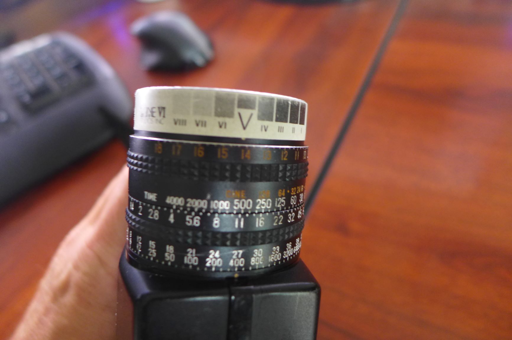

The Soligor has a dial you turn based on the EV reading from the viewfinder. When the meter arrived, the previous owner had taped over the indicator mark (where you line up your EV reading) and called that Zone V (see below). Using that designation, my photos were overexposed. So, I taped over his tape, and put Zone 5 one stop lower (to the right). After doing this, my bricks in the picture above ended up on the new Zone 5. I now realize that I should have moved the markings yet another stop lower so that the bricks fell on Zone 6 and, as you say, the grass fell on Zone 5. See the picture below of the dial and tape I am talking about:

You can ignore my word salad. I have it figured out. Thanks!
The previous owner probably didn't tape a "Zone VI" label to the unit. I'd say it's probably a Zone VI conversion (my Soligor and Pentax conversions have identical stickers). Pentax Spotmeters, as well as Soligors, were converted by Fred Picker's company. That included replacement of some of the sensors. It's likely that a Zone VI conversion will read slightly differently than a "stock" Soligor; at least mine does (about 2/3 EV).
Maybe that's the case here. This meter overexposes everything by about two stops, though. Does Fred Picker's company let you choose how much difference you want in exposure? Maybe the previous owner asked that it be made to overexpose by that much. Two stops really isn't that big of a deal for film, which is what I'll be using it for, but I'd rather make that correction in my head.
Also, I have seen Zone VI meters for sale on KEH before, and they usually list them as "Zone VI Modified".
Here's a link to a thread which is 18 years old. It discusses Zone VI modifications. Zone VI is long out of business, and Fred Picker died in 2002. My Soligor was found in an antique shop, costing me $65, and the Pentax was @ $300 at a local used camera shop.
http://greenspun.com/bboard/q-and-a-fetch-msg.tcl?msg_id=005Fv4
I know that KEH is very scrupulous about their listings, so I could only surmise that it was an oversight in your case.
