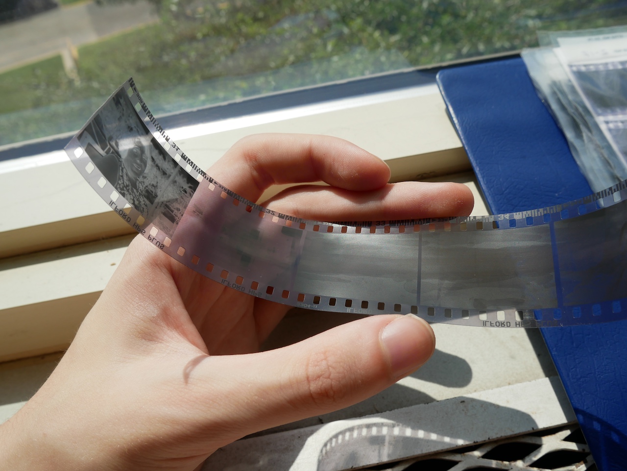

I've only started printing my negatives recently, and I've noticed these streaks running down the length of my film strips. You can see them on the emulsion side. They're less visible on some shots than others and only on my 35mm negatives. At first I thought they were drying marks, which I've definitely found on other negatives and I've cleaned off with isopropyl alcohol to some effect. I tried searching online but haven't found anyone with similar problems. It's really frustrating because my medium format negatives don't have them and I develop them the exact same way. Anyone know what they are and how to prevent them?

Try rewashing in distilled water and then a dip in DW with Photo Flo. It does look like a residue from the water.

Wiping with fingers can cause scratches.

Allright, now I'm getting frustrated. I just tray developed a sheet of 4x5 film. I washed it for a few minutes in a tray with distilled water and a little bit of photo flo, agitating every 30 seconds or so, and I still had drying marks. What am I doing wrong now?

Probably nothing - sometimes these things happen for no apparent/ clearly identifiable reason. Depending on film type / fixer type / process temperature I have had problems with marks, too. Seems the local water at my place is not helping.
I have taken 2 measures:
1.) Hardening after fixing - I had problems with soft emulsion on Rollei RPX400 - which seems to have greatly increased the problem.
2.) Final wash in DW, then Photoflow bath (with DW) and then a few rounds in the salad spinner.
The film comes out wet but without any drops and dries quickly, without significant spots.

Is the film drying in a similar climate (temperature + humidity) each time? I've noticed issues when drying environments change and there is more moisture in the air.

Did you use PhotoFlo or an equivalent? Do not wipe or squeegee the film. Instead use a paper towel at the corner to draw off the water.

How much photo-flo? a little goes a long way, and it's really easy to get too much.
Follow the directions on the bottle. There are two different types of PhotoFlo: one dilutes 200:1 and the other dilutes 600:1. Use those ratios, putting a drop or two in water is not accurate enough.

YMMV but I stopped having dirty negs as soon as I switched to Ilfotol diluted per maker's recommendations (1+ 200).
Use very gentle agitation and feather-light manipulation after dipping the negs into the stuff. Otherwise the agent will foam and you'll get stains on your negs.
Mark the date you 1st open it on the bottle. After 1 year it's time to dump it and buy a new one.

I'm betting your using too much photoflo. After I quit using that I never had another problem with drying marks or streaking. I hang the film and squirt both side of film top to bottom with distilled water (or DI) using a fine-tip squeeze bottle.
