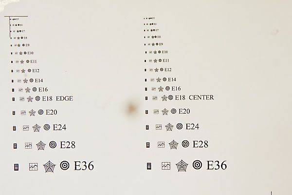

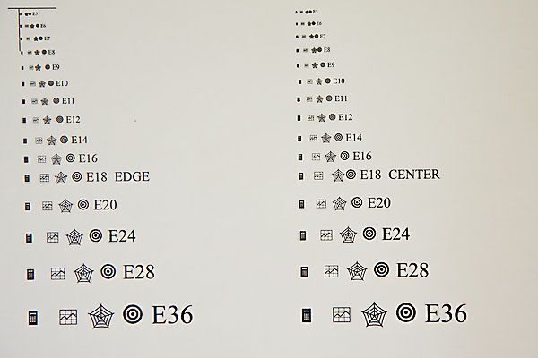

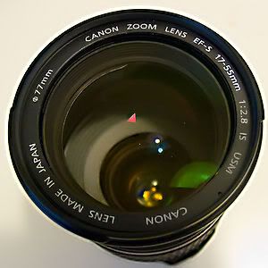

Some time ago I did a little test...deliberately put a large object on the surface of a lens to see the impact on image quality.
The shot wide open (f/2.8)
Then at f/16
The OP photo shows sensor dust, well defined and especially noticed at small f/stops
