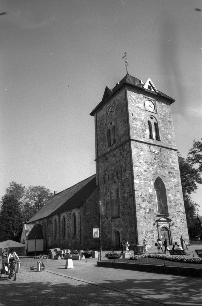

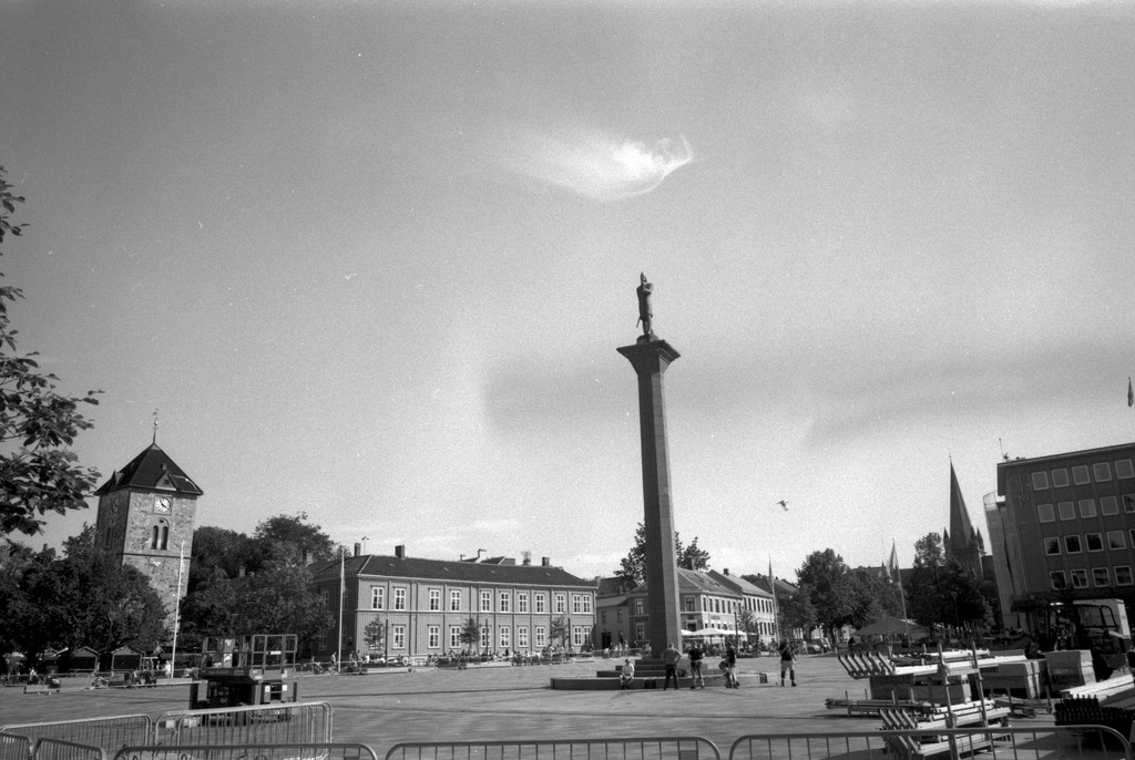

a roll of 120, the last 2 frames: horizontal long dark marks
#8:
by the bell tower (on by the top on each side these short thick streaks???)
#7,
across the sky:

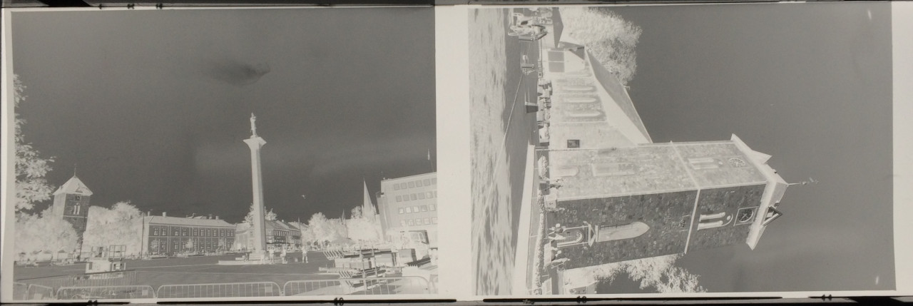

yes I forgot to mention the digitalization/printing: it's an Epson V700 scanner. Of course on the negative it appears as lighter area, but I scratch my head about the cause:

Yes, I agree that is a strange defect. It looks underdeveloped, how that could happen and form the lines is beyond me???

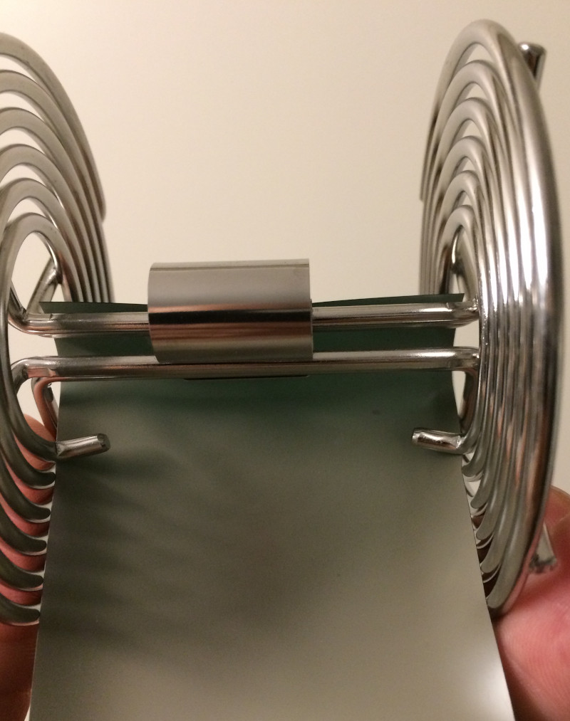

The two short thick streaks in the corners of the last frame might be a mark from the film reel. Their location and symmetry makes me guess that. Is it possible that that was the end at the center of a steel reel, and the film contacted the ends of the spirals? (the inner ends of a steel reel spiral are usually bent down a little)
The larger, more indistinct marks, I don't know, possibly fingers touching the emulsion side of the film while loading?

yes that's exactly my hypothesis: the two symmetric black notches can only be these two small bents near the core of the spiral. I never had it before though... I guess exposed emulsion doesn't touch these bents unless there was some glitch with the alignment/start/spacing of the roll inside the film, so last frame ends too close to rolls end.
as for the other marks, yes I probably had a residue of something on the middle and index fingers tips. I wash hands before manipulating rolls but I must have been sloppy.

I always load emulsion in. It tends to match the curve of the film so loading is easier and there's little chance for the film to buckle. Also it means if I do touch the film, it's likely on the base side. However, this is very much personal taste.
Typically, the way most steel reels are designed, the film doesn't touch those bent ends, because they are bent in toward the center as well as down.
However, if one starts the end of the film a little oddly, for example missing the clip and just stuffing the end into the center of the reel, it may be possible for the ends to touch the surface. I don't know if I've ever had those marks, but I've certainly done odd things like missing the clip. A few of my 35mm reels don't even have a clip, just a sort of C shape intended to contain the film end. I load film in a changing bag, so I have to get the film started without messing around for too long, before my hands start to get sweaty and annoying (and of course I would rather not touch the film with sweaty hands).
