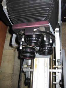

Here is a pic of the turret on my enlarger, showing the three different lenses I have mounted on it, and the bellows' extended a typical amount for one of the longer lenses:
Hope this helps
Edit: as Michael says above, the bellows will also extend or contract as you change magnification. You just won't notice it as much when you are printing from 35mm negatives.
