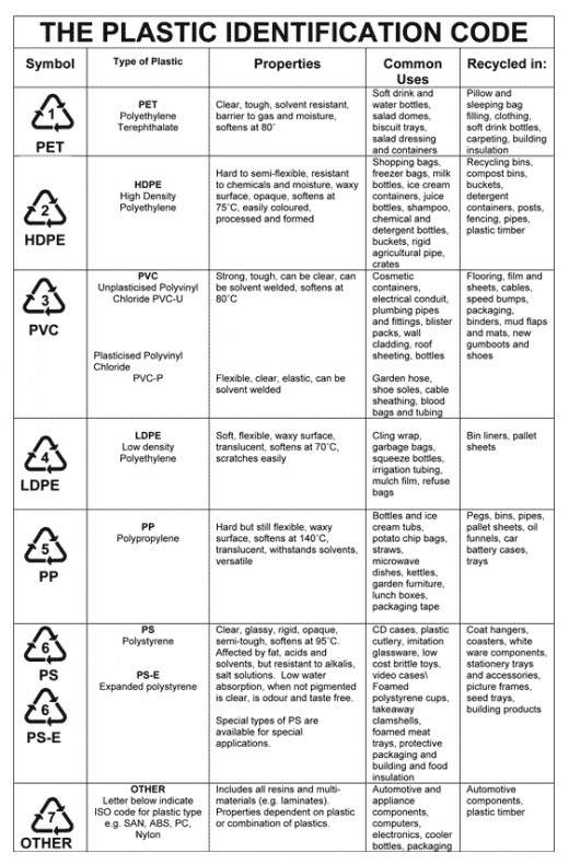

Feb 10, 2010
2,793
Flintstone MD
Somewhere on it may be a distinguishing mark. See this chart for details. If you cannot find the mark the manufacturer (or perhaps a seller) is the only way to be sure.
