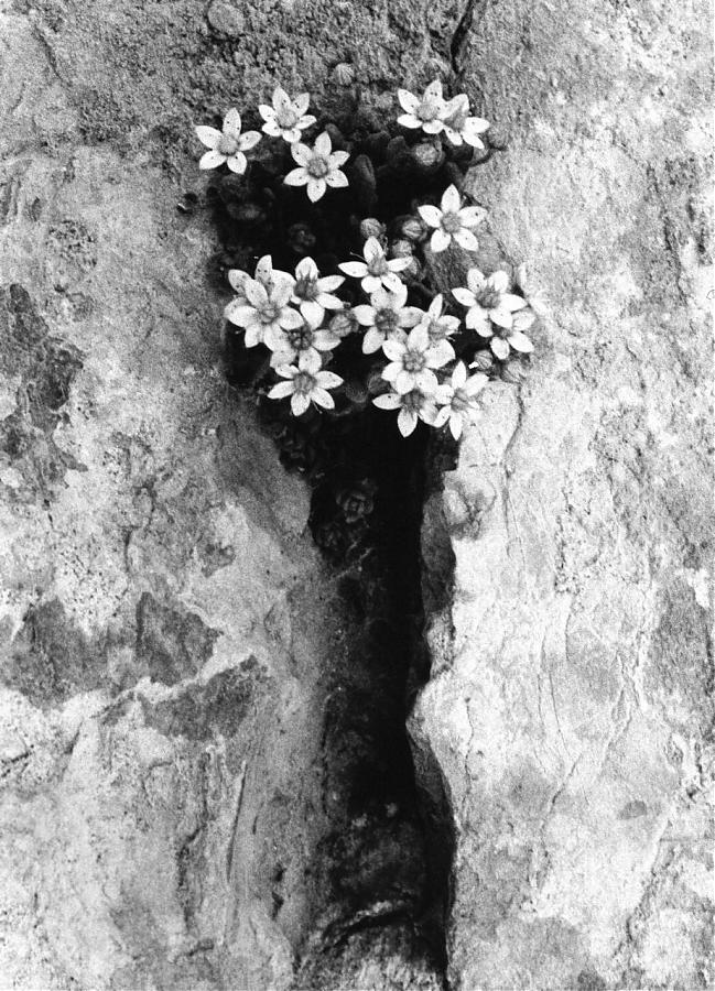

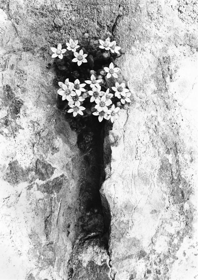

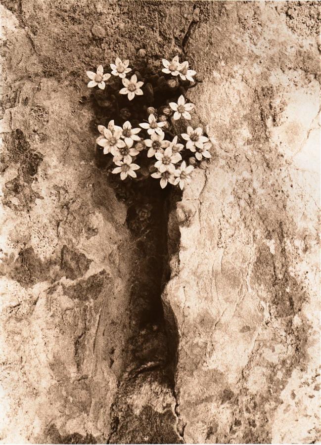

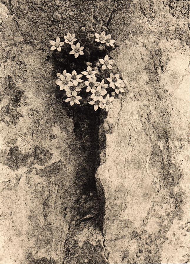

Here are some different papers from today's session...
Yesterday and today I worked on lith-printing an image, using MacoLith for the first time. The development went so fast that I doubled the recommended dilution. Since the developer didn't seem to exhaust after 3 or 4 prints like my usual Kodak Super RT, I continued onwards once I ran out of Fomatone and decided to try several other papers. I managed to lith 20 papers in one developer prep; that's a record for me.
-print 1 is a straight print on Ilford RC pearl
-2 is Fomatone VC RC WT velvet at gr.4
-3 is Forte PWT RC semi-matte at gr.3
-4 is Ilford WT... which still sucks for lith in my house for some reason
-5 is Kentmere VC WT FB at gr.3, a moderate amt of pepper fog
For this image, I like the grain/texture and the colour brought out by the lith process, but I think I like the straight print for the contrast...
MGWT does not lith like the more lithable papers do and the large/small grain effect is less pronounced, but you can lith process it and it has a look of its own - not as 'lithy' as others. I known that it is a favourite of Bob Carnie's.
Personally, I find it easier, or perhaps that should be 'more to my liking', to lith it in hot lith developer. I find it responds 'better'.
However, the TRUE strength of this paper with the lith process (in my opinion) is with what I call 'second pass lith', i.e. redevelopment in lith after bleaching a normally processed print. The results will vary with the ist pass developer used.
Try it - it splits like a charm ;-)
Tim

I really like the Kentmere print
Thanks, Tim. I WILL try out your techniques. In the past I've beat my head against the wall trying too make the Ilford work as straight-up lith. It's such a nice paper for me otherwise and it's so available. Your advice is just the ticket.
Thanks, Scott.
The more I look at it, the more I like it. I posted it up literally 10 minutes post microwave and dry mount press so hadn't had a chance to appreciate it. It's up on the Fridge Door Gallery now, in good daylight.
It's a bit grittier than the others, I'd say a hint of yellow-gray in with the blacks. I'd not had good luck with the Kentmere in the Kodak SRT; brutal pepper fog. So, it's risen up in my appreciation scale...

I really appreciate you doing this paper comparison. It holds great value. I too like your Kentmere Warmtone image, and I have used it before in a print exchange. I got pepper fogging, but I don't dislike pepper fog, I love it with certain subject matter.
A paper you should try out some time is Fotokemika Emaks. I got a 16x20 from Guillaume Zuili that is outstanding in color and grain. A deep, rich chocolate black after selenium toning.
Your examples are really nice. I like all of them actually, but the Kentmere has something extra.
