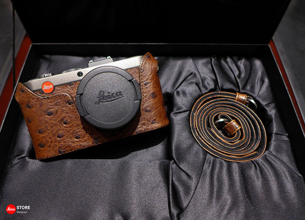

You don't consider the ostrich-covered Leica X2 Lamborghini 50th AD SE a necessity?

Do you remember the Hermès Leica with the leather peeling off while still in the display case?
