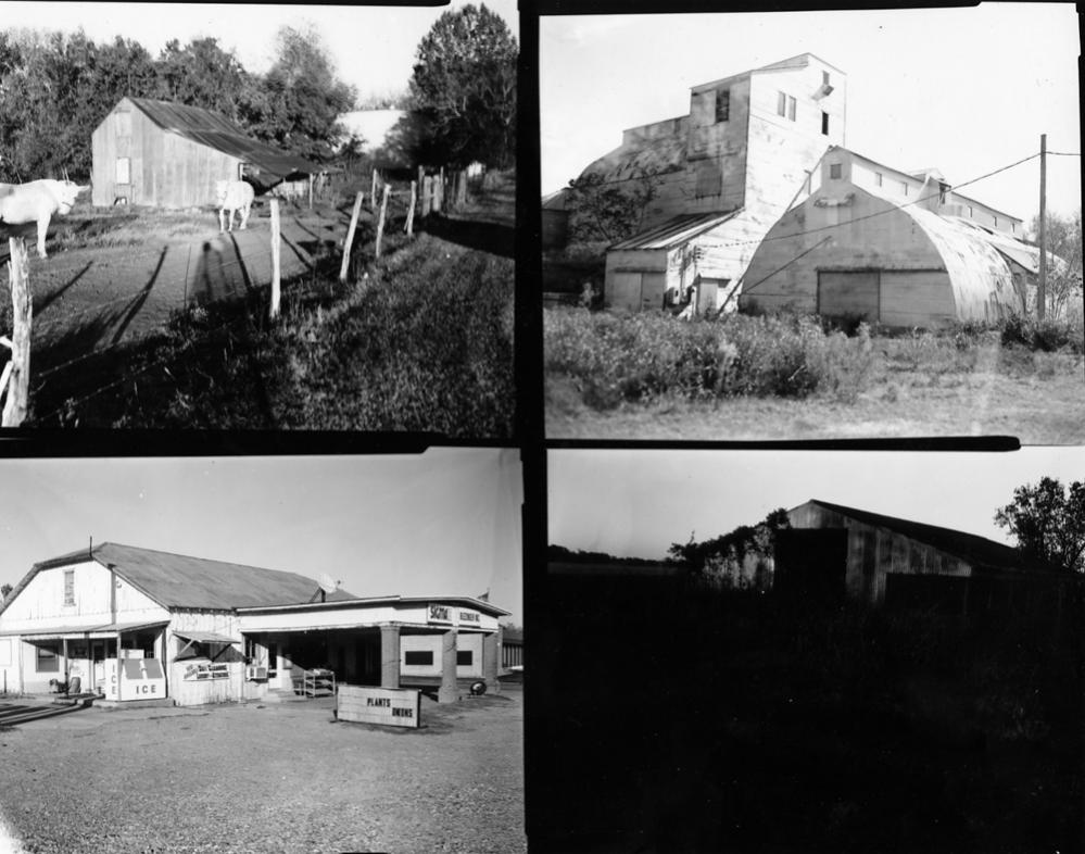

My three camera mistakes so far with my Crown: 1. did not reverse the darkside after taking a shot. 2. scratched film while [un]loading holder, 3. shadow self portraits too many times 4. too embarrased to say. <face turns red>
Developing has been relatively fine, but I had a lot of roll film experience. Did a 4 negative contact print on one 8x10 sheet, 3 came out looking good but one was severely underexposed, compared to other three.

... Did a 4 negative contact print on one 8x10 sheet, 3 came out looking good but one was severely underexposed, compared to other three...
Steve.
When doing contact sheets you can tell which negatives are relatively under-exposed. With experience, you can tell if the "overexposed" negative needs 1/2 stop, 1 stop, 2 stops more light and adjust the exposure of the contact sheet accordingly. Make some 4x5 pieces of mat board and simply pause the timer, cover the less exposed negative, resume the exposure, etc. Alternatively, use a larger piece of matboard and do a "hard burn" on 1/4 or 1/2 of the sheet if you arrange the negatives properly.
my poor attempt
Here is my poor attempt at LF photography, printing and scanning! Dirty, passed around print too. Exposure was what I cared about.
I made slight adjustment to levels and sharpness to match print.
Top left photo was not focused.
I am going to find some less contrasty, much closer subjects Saturday.
I know they are bad but how bad? (fyi Crown Graphic 135mm Optar txp320)
tia
steve.

First, that's not bad for a beginner. Second, don't be embarassed. We've all screwed up one time or another. I can't begin to recount here just how many times I've done it. That's why earlier in this thread I wrote what I did about using the less expensive film to start.
Now go out and have some fun with your Crown.
Does your's have a working rangefinder? Mine does. It's great fun taking it out and using it hand held for street photography.

Frank, your words are too kind and I thank you for your encouragement.
The rangefinder apparently is inoperative, something that was not disclosed when I bought it. I might have used it because the glass on this thing seems very dim. I hope the Shen Hao will be brighter.
I am off to take some evenly lit closeups so I can gauge my ability to meter and develop simple scenes, plus test the focus on the lens. I have a lingering suspicion my shots are unsharp. With contact prints, they should be perfect, right? I can't effectively enlarge because I just have a 100mm lens.
