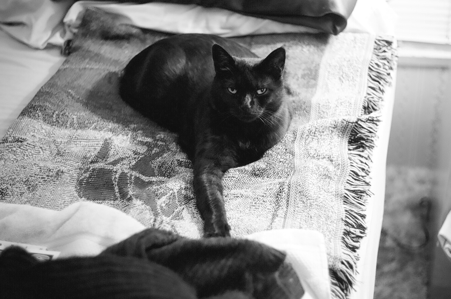

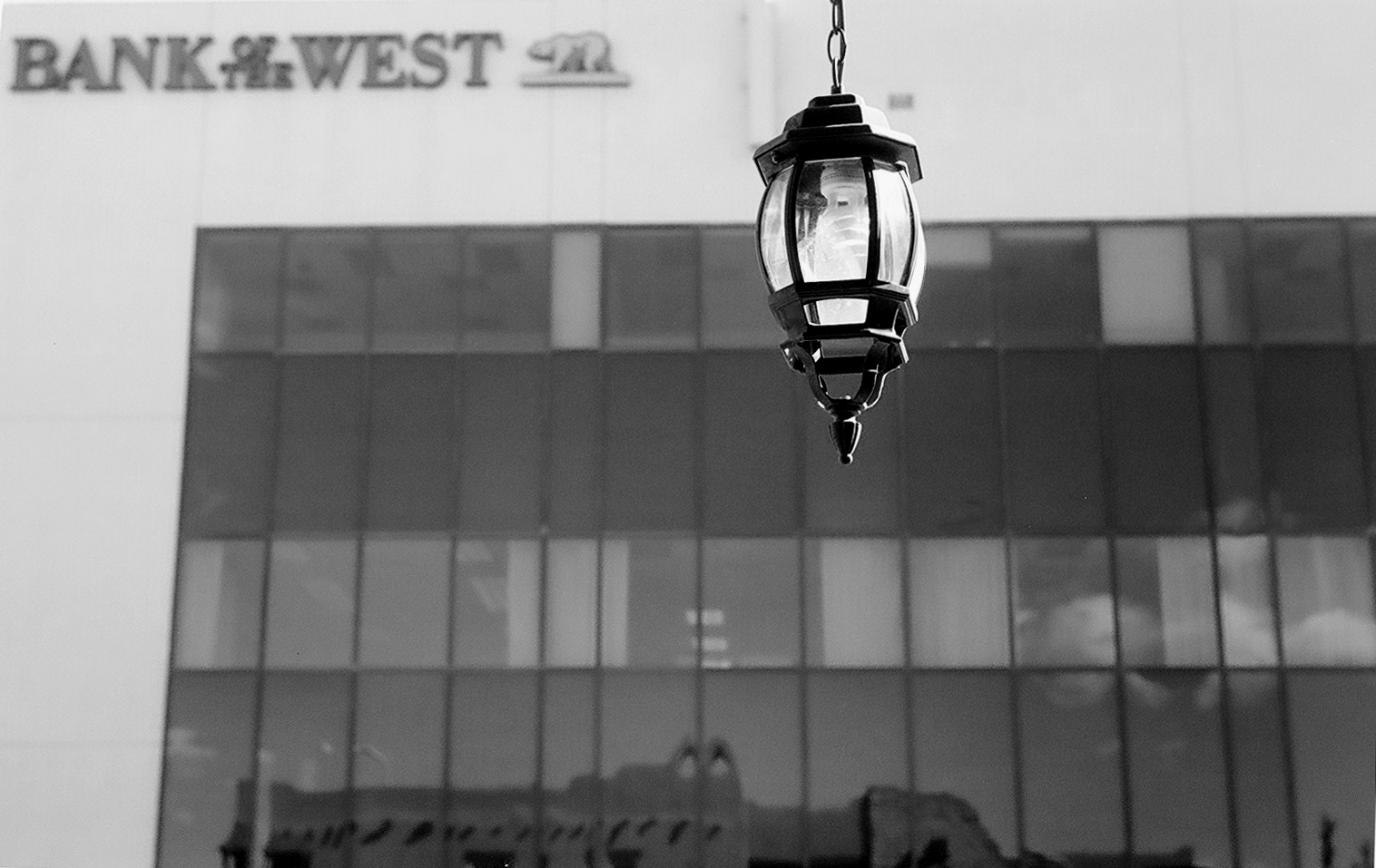

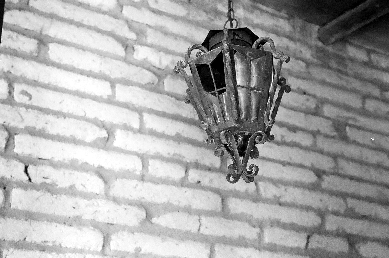

All the qualities you mentioned aren't really how a clean Summar images. These are very old lenses, and often suffer from internal haze and fungus, which has given most people a false impression of what they're capable of (swirley bokeh is from Summitars, not Summars). I had one in that sort of condition that flared like crazy, so it got sent off to John at Focal Point Optics for a CLA. It came back as one of the best lenses I've ever used, with great sharpness and classic Leica IQ.
A clean Summar is a fantastic lens. Just put a hood on it and a yellow filter to bump the contrast up a bit, although if it's clean it will have plenty of that. Here's some shots from mine. I valued it even more than my Summicron DR. The 4th shot of Sissy on the bed was at F2.

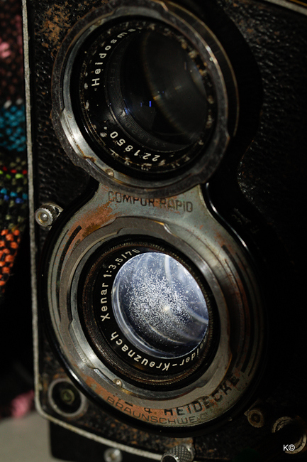

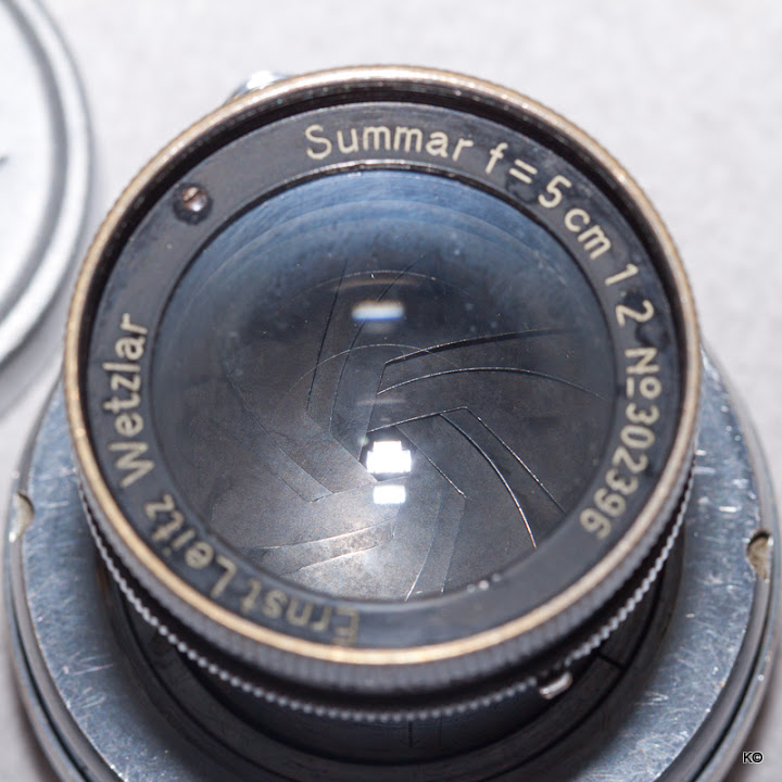

My Summar was like OP's Summar, until I spend twenty minutes to clean it just a little bit.
And...
So, guidance is simple. Any trashed lens will do, coated, uncoated, doesn't matter. Once lens has non-removable patina inside it acts as OP wants.
Seen it.
Lens should looks like this:
attachment.php
Or you could take suggested Nokton (SC, MC they are no real difference), Skopar 35 2.5 or J-12 and apply Vaseline. Glow, low contrast and no sharpeners will be with you.
