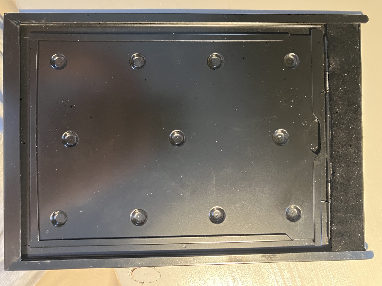

I am going to modify a sheet metal film holder for wet plate use. Is silver nitrate very corrosive on steel?
The film holder is made of steel, no plastic parts. I am not shure what kind of steel this is but it is thin and seems to be easy to form and weld.
How do I protect the steel against corrosion? Some kind of laquer or silicon spray grease? I dont want something that can migrate in to the collodion layer or on the surface that affect developing. Any ideas?

Usually you remove the film holder and use the plate holder without the film holder, so I’m confused how you will use a film holder.
You will need to keep everything clean whether it's plastic or metal. I use both.

Thanks. Then I will repaint it when done with modification.
Awty: the film holder will be removed. I am going to drill the 11 welding spots to remove it.
