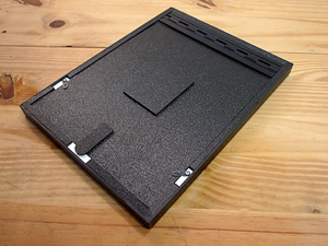

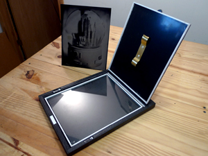

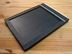

Hand made, dedicated wet plate collodion holder that can be used with any 8x10 camera without modification. Although this holder may show a few minor glue and cosmetic marks associated with hand-made construction, it has been used to test light-tight, it is being sold as new.
-8x10 Wet Plate Holder
-Plate size approx 9.75 x 7.75 inches
-Works with glass or aluminum plates
-Glass backing plate included (not needed for glass plates)
-Tension sprint attached (no need for loose springs)
-Satisfaction Assured
For a kind and positive review, read (there was a url link here which no longer exists). He was one of my testers and I am very happy he liked the holder.
APUG Price: $300.00 US - shipping is 10.50 in continental US for USPS Priority Flat Rate Medium Box - 44.50 for USPS International Priority Mail
(Planned retail for these will be 350.00 through our web site and any dealers)
Sorry.. Payment accepted vial Paypal only at this time. If interested or have questions, please feel free to PM me.
Thanks for looking!
Bill
