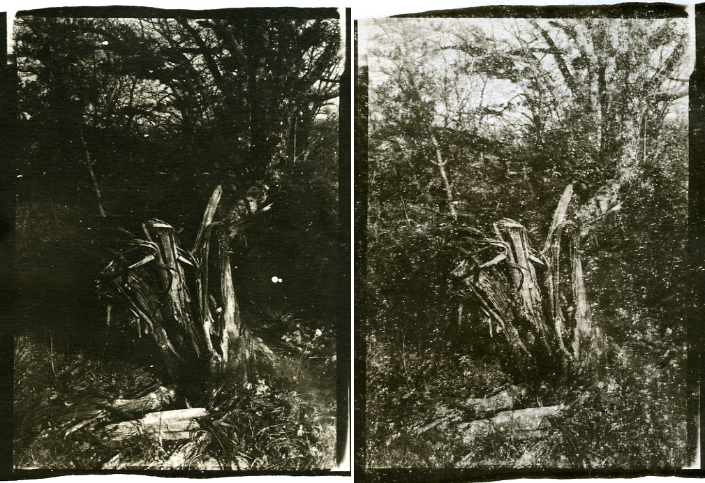

So far, I had only been coating on wet paper, so I tried to coat on dry paper.
I coat with a 4 mil coating rod (I know it's too thin but it's what I've got).
See comparison below, the dry coating is not uninteresting but...
These are contact lith prints from X-Ray negative
di de
Dec 18, 2011
36
Marseille, F
sorry, english is not my mother tongue, I don't exactly see what you mean... feel free to correct...

I would like to know which is the wet and which is the dry coated between the two samples.
di de
Dec 18, 2011
36
Marseille, F
Denise, thank you
I was surprised and a bit worried how the dry paper curl instantly after coating... but it seemed to be ok...
The thickness I coat seemed not to be much a problem on wet paper but is clearly an issue on dry paper.
I think I will continue to coat on wet paper but keeping in mind that "dry paper effect" which can be useful with some images...
I have to find a glass tube in my neighbourhood to build a puddle pusher so I can adjust the thickness of my coating.
