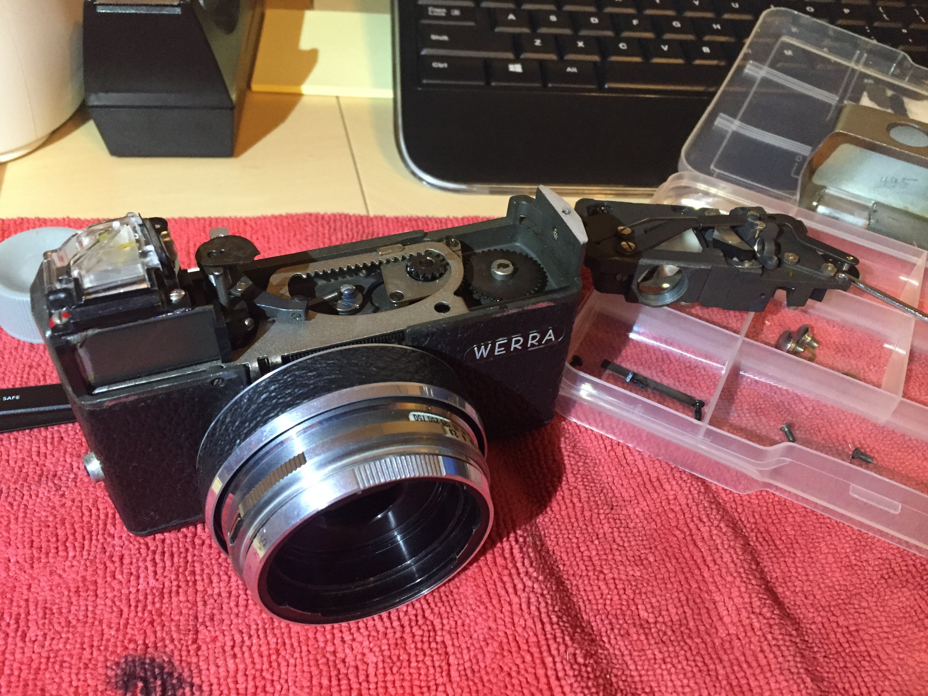

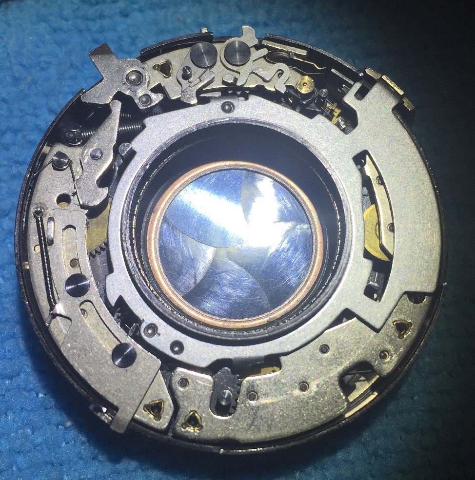

I must say, this has been one of the most challenging tear-downs I have ever attempted...
I have a Werra V, Mark 2 with a Prestor RVS shutter that I purchased five or six years ago that had a frozen shutter but was in amazing shape otherwise with Carl Zeiss Jenna 50mm f2.8 and 100mm f4 lenses, case and accessories; even the light meter worked.
This was just about the time I fancied myself a budding camera repairman,so I carefully removed the shutter and plunked it down in a bath of naptha. It freed-up for a few shots and then locked-up again. After about 3 increasingly long baths in naptha, I became impatient and went for the acetone.
Bad move.
The shutter totally seized and after poking around on it for a few hours, gave up and put it in a storage bin with notes and careful diagrams.
Fast forward to about a month ago; I ran across the camera and decided to give it another go.
It has been quite the education.
First of all: the Prestor RVS has insulators on the flash sync connectors that dissolve in Acetone. The plastic like material had redeposited throughout the shutter and the metallic connector (buss) that carries the electrical connection from the shutter to the sync port fell out in two incredibly tiny assemblies that took a bit of puzzling to determine how they worked and where they went back. I had to fabricate a spacer made out of waste plastic to replace the dissolved insulator, but I think I was successful.
I then took couple weeks clearing out the dissolved insulator with more acetone after determining that no other parts would be dissolved.
After that, I started what I call, "the prestor dance" of reassembling the cocking, speed detent and cover rings on the shutter. Whoever designed this fiendish shutter was either a genius or a total madman. You need 4 pairs of hands, the eyes of an eagle and the patience of Job to reassemble the top of this unit!
I now have it to where I can assemble the unit, it will fire ONCE and then jam. I take it apart, examine it carefully and do it again. Exact same problem.
I have been consulting Simon Hawketts' very instructive Camera Blog posting on his Werramat repairs, and tried to contact him, but so far no response.
I am missing some subtle step in the reassembly process.
Anyone have experience with this shutter?

Has you read through this repair thread? https://www.rangefinderforum.com/classics/forum/messages/2/15994.html?1266642092
I suggest replacing the volatile chemicals with 90% alcohol and flushing it face down in an ultrasonic cleaner with the face removed and submerged in the alcohol. Run the ultrasonic for 3 to 5 minutes, allow to cool for 15 minutes then repeat 3 or 4 times. Warm to hot alcohol will strip the finish where finger oils are present or the shutter has been handled regularly.
It may be similar to a Prontor shutter in design. Prontor shutter repair manuals can be downloaded from my google drive, https://drive.google.com/drive/folders/0B1sPJkp-MdghNGM1aGY5akgtTmc
A shade tree camera repair persons alignment tool is useful for stubborn cameras. https://www.homedepot.com/p/TEKTON-3-lb-Sledge-Hammer-31103/205560102

Thanks! I will go back and re-read that thread more closely, but I do recall looking at it once...
Profuse thanks for the Prontor manuals! I wish I had something to offer in return; I have a document on fabricating camera repair parts from scratch coming to me via mail. Would you like a scan of that?
Do you use any insulator to keep the shutter from resting on the bottom of the ultrasonic cleaner? Since the reservoir on my cleaner is so large, I might place the shutter in a small, thin container with alcohol and float that in the reservoir to keep the volume manageable.
As for adjustment tools, I have been exploring something in the megaton region...

I have a small ultrasonic cleaner that holds about a pint and a half. It has a plastic parts basket with 1/8 inch square openings in it like window screen.
Strip the insulation from electrical wire the same internal diameter of the flash contact parts for insulators. Some shutters use nylon bushings.
I've encountered some shutters that the pivots would not come clean until they were disassembled and flushed out then rubbed with a round wood toothpick saturated with cleaner.

I stuck the shutter in a small ziploc bag, filled it with 99% iso and then put another bag around that and hung it in my ultrasonic cleaner in a water bath for the times you mentioned tonight. Will let it dry overnight and see how it feels in the morning. Thanks!
I don't blame you for quitting... seems a rather peculiar way to "relax".

UPDATE: the front shutter is firing reliably now after a few more cleanings and a very light dusting of superfine graphite, but the capping shutter will not function on a regular basis. I have found, however, if I ever so slightly push the shutter cocking lever toward the extreme end of its terminal travel, the capping shutter functions 100% of the time. This suggest to me that the main cocking spring has stretched slightly and no longer supplies enough tension to latch the capping shutter lever after firing. I'll have to try to shorten the spring a few coils; I hate doing that. It is so easy to botch...

Well I shortened the main tension spring and the shutter fired OK repeatedly outside of the body, but upon installation it seems to have reverted to it's former tricks.
Ah torment...
So its the mounting on the body causing the troubles. I've seen shutters that would operate properly with the face plate/speed ring loose but fail when they were tightened correctly.
Look for something in the mounting causing a bind.

Thanks Shutterfinger, but stick a fork in me, I am done.
At least it leaves a pretty corpse...
