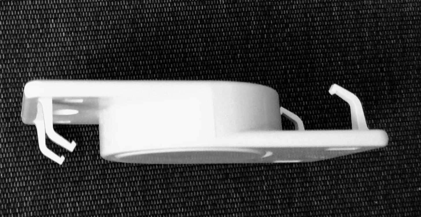

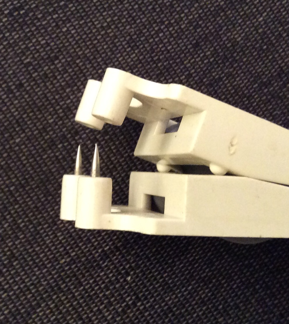

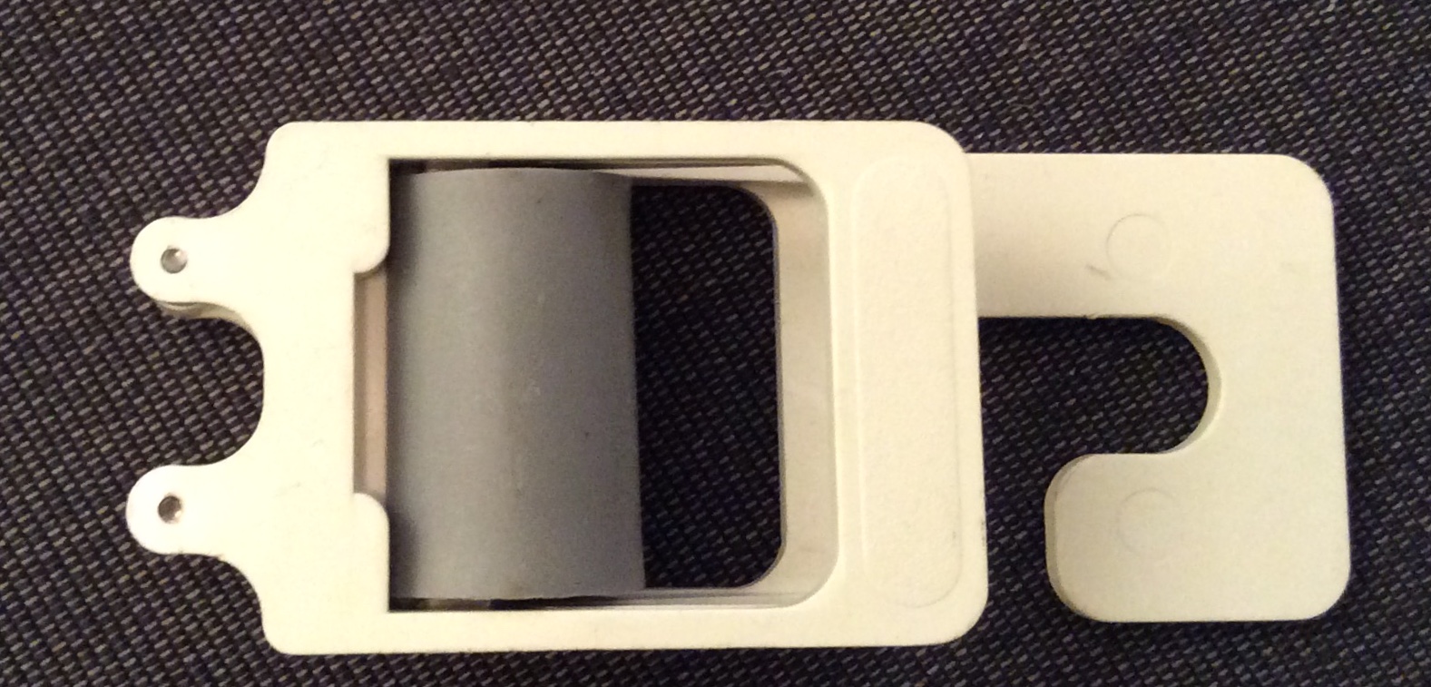

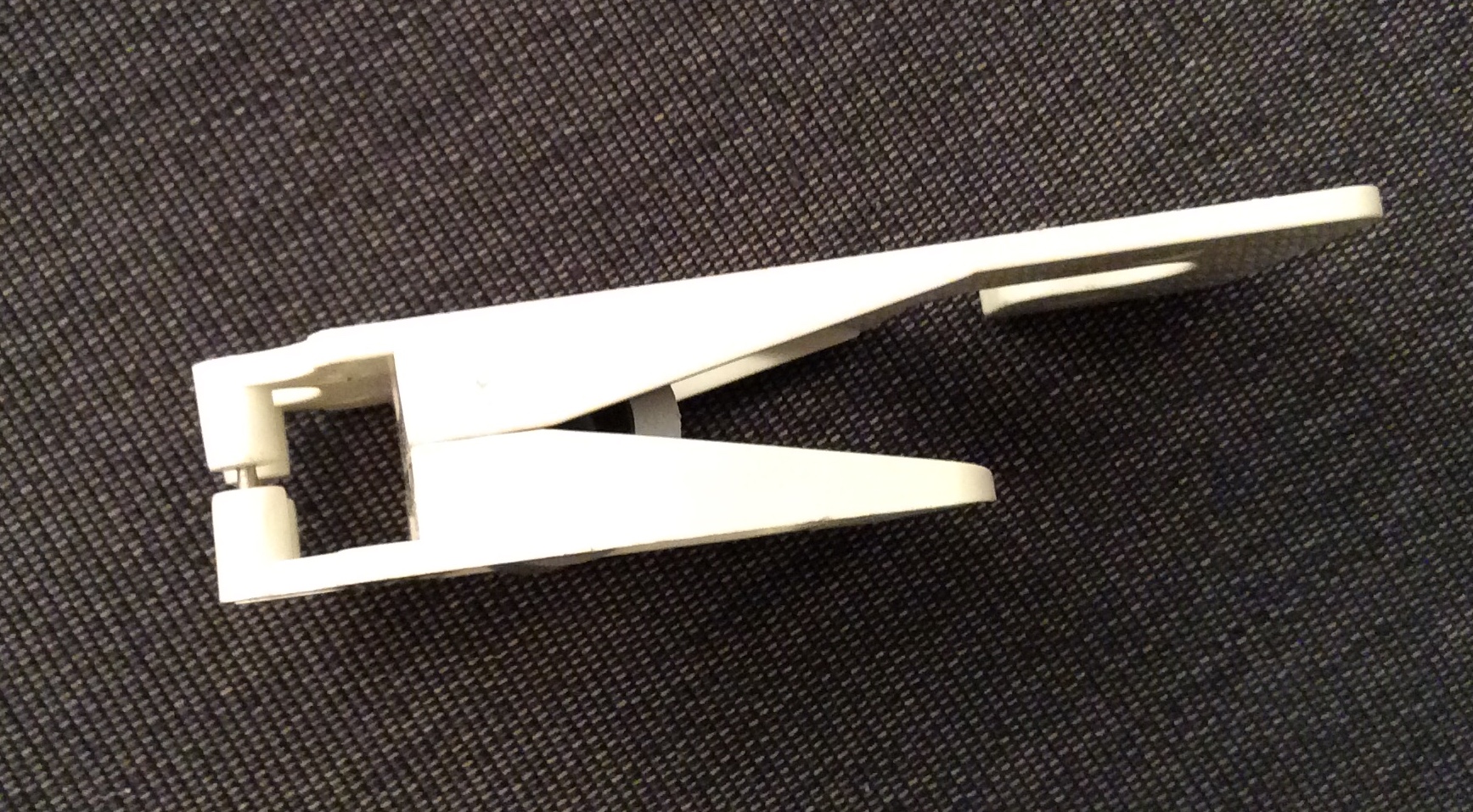

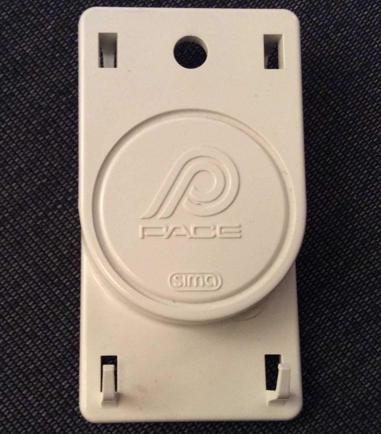

5AE28F2B-AEBA-47DD-8377-1791F4562BE9.jpeg 5C0EC461-0D65-4200-9B50-8DC5229C5FCC.jpeg 21FECF80-5CC0-467E-9D8A-CEC12AFF1251.jpeg E9E1C770-D4D0-48A8-AA7F-1EAB62562E94.jpeg DECF9A7F-E683-4A5A-8AF2-DF9CBDF1FBEB.jpeg
SIMA made hanging devices with small hooks for sprocket holes — the hooks were at both ends, so you could hang one end on the line or, if developing shorter lengths, hang several in a series. See photos attached. I like to use them because they hold the film without retaining any liquid. I have other makes which grip the film but dribble out hidden liquid when you unclamp them — the film is dry but the unseen liquid is waiting. I have some that crimp or quasi-penetrate the film, but those can twist or wrinkle the film. I’ve also posted photos here of a Paterson clip (made in England) that has two sharp points that easily penetrate the film. Note that Paterson had the wit to design them so that the plastic clip hardly touches the film.
