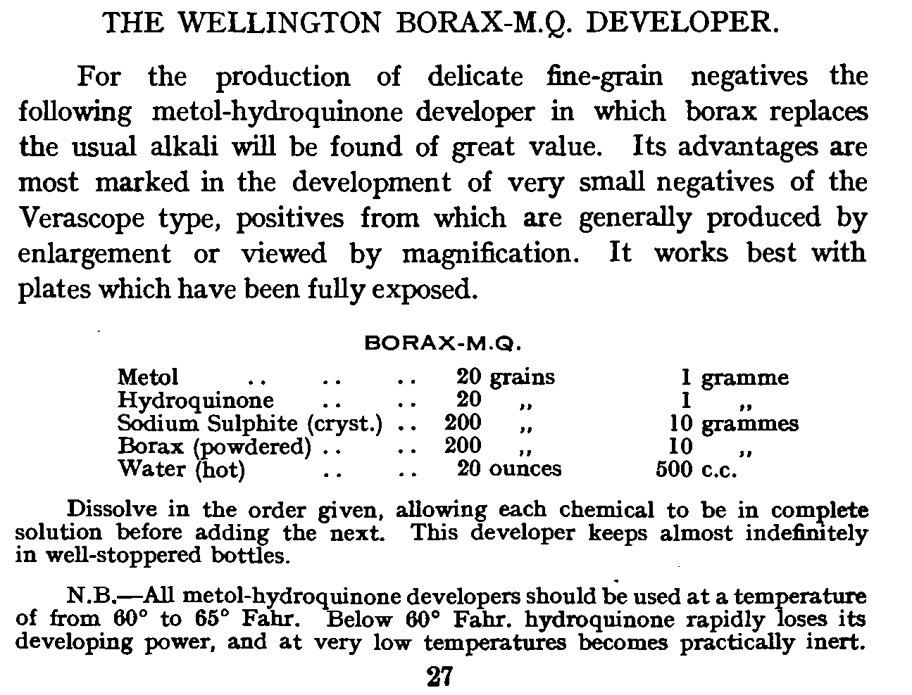

The earlier Tenth edition, probably about 1920 , had a slightly different formula, this may have been provisional while they re-worked things after WW1.
You'll note this earlier version has the same Metol & Hydroqinone proportions as D76
Wellington Borax MQ
Metol 2g
Sodium Sulphite (anhyd) 10g
Hydroquinone 5g
borax 20g
Water to 1 litre

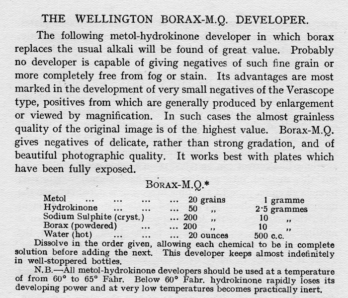

At some point Wellingto altered the formulae (or it was a typesetting mistake), this one above is in the 10th (thanks Alan) & 11th Editions but by the 15th the Hydroquine is listed as 2g per litre,
From the 15th Edition
Ian
