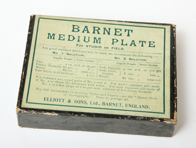

I had some Ilfobrom from the 60's also Kodak Bromide papers and both were fine no base fog and not much drop in contrast maybe half a grade. I gave away about 500 sheets ironically on the Ilford car park at Mobberly.

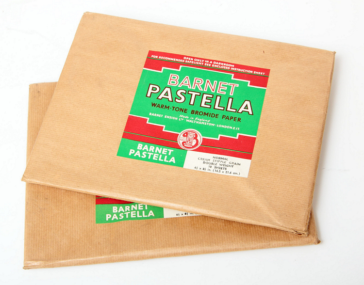

It's warmtone papers that age the quickest but I've my fingers crossed for the Barnet paper I acquired recently.

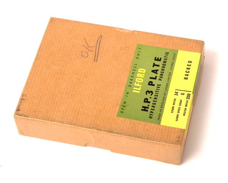

I've also some plates for my Quarter plate cameras, I cut my teeth on HP3 .
You never know until you try these older items but might be surprised.

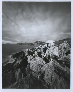

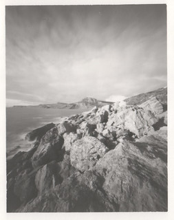

Well, I was doing a little contact printing last night so I thought it would be fun to try the 3.24M ... I tried developing an unexposed strip first, and it came out OK, just a hint of cream colour.
Here's a couple of scans (I have a very old, tired, low-res Mustek scanner so the quality isn't fabulous ... although also please bear in mind that I have only been printing for about two weeks)
These are contacts from Fomapan 200 5x4 sheet film (pinhole camera). One's on Fomalux 312 contact paper, the other on the Ilfospeed.
I expect you'll be able to work out which is which ...
