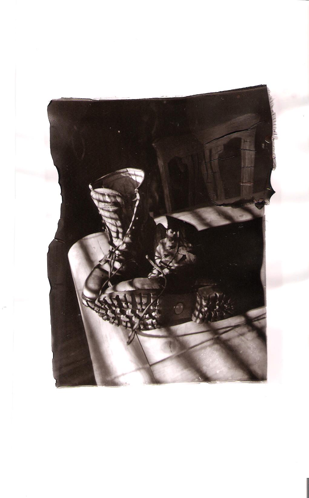

Finally, my first successful(some what)carbon print. I didn't have any rubylith tape to make a safe edge and lost some of the emulsion during the transfer. Hey, I'm happy about it anyway. 4x5 camera negative on 5x8 fixed out Kodak paper. It will only get better from here.

Thank you Lyle, unfortunately the emulsion wrinkled and has a couple tears. But what the heck, I love it.

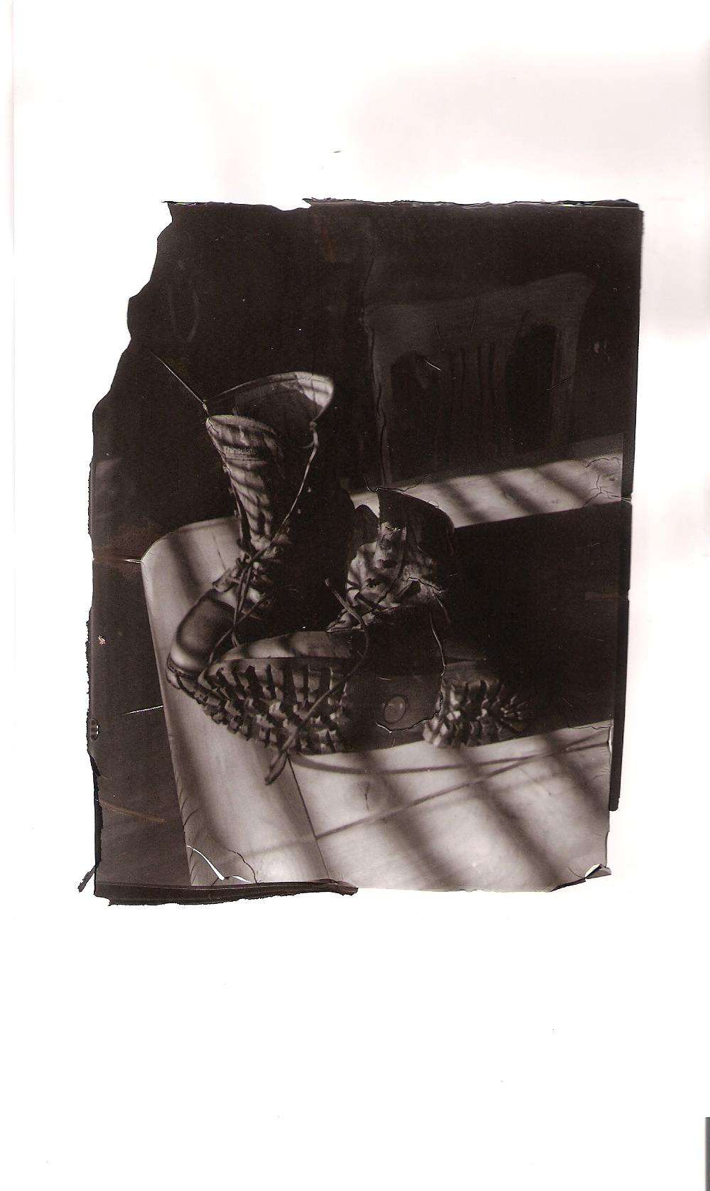

Second attempt with same negative. I cut the dichromate dilution and gave longer exposure. I'm happy, though I am still having a slight problem getting the gelatin to adhere to the final support. Maybe my water is too hot.

A safe edge around the image should prevent frilling. I use red electrician's tape. I'm not concerned about the tape melting as I usually use BLB exposure unit, and when I use my halogen unit, the exposures are quite short. Your local art supplier should have sheets of rubylith…a bit expsenive, though. What are you using for a final support?

I have been using fixed out Kodak single weight paper for my final support. I used a sheet of mylar with black electrical tape for a safe edge this go-round, it helped a bunch. I think my water may be too hot though.
