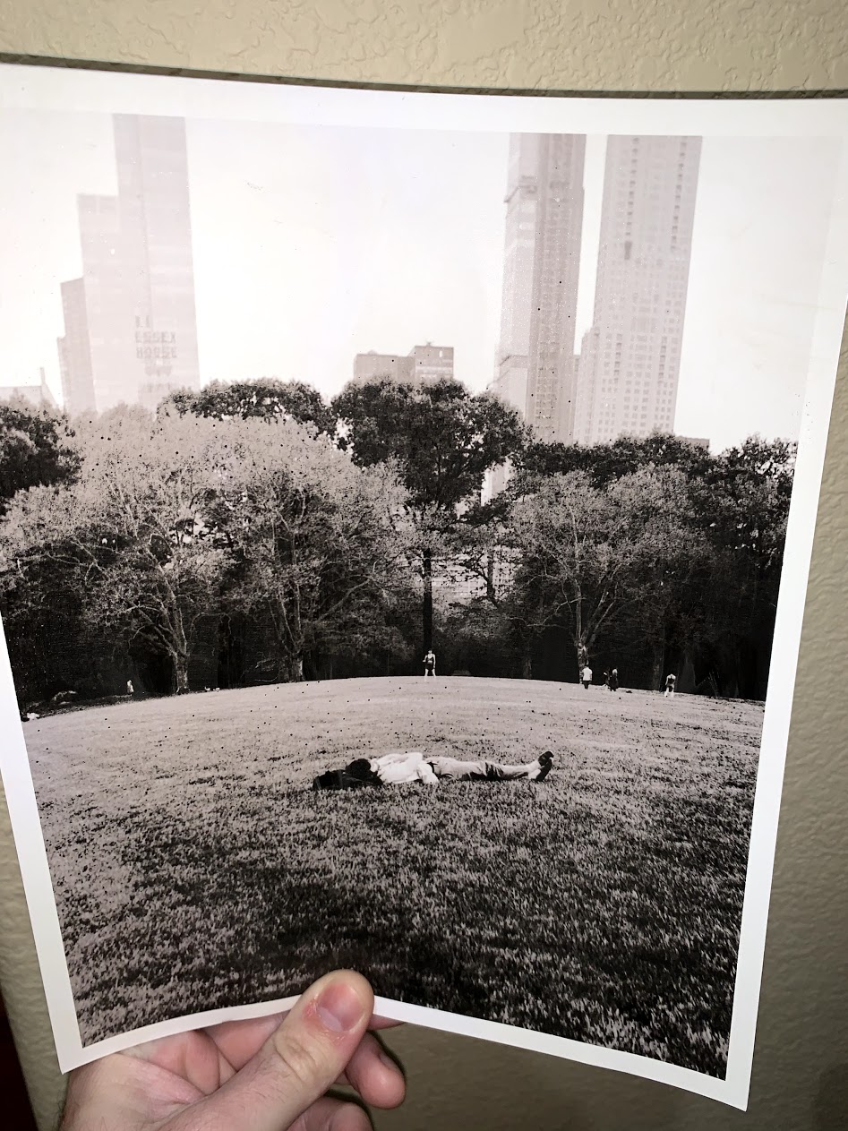

Description of this print:
Ilford Warmtone FB first-pass lith printed in ModernLithC1 prototype formula.
After fixing it was toned by an experimental method of dunking the print directly from the (well used TF-4) fixer into a strong oxalic acid bath, causing the bath to go white with precipitate and become quite smelly. Before toning the print was fairly neutral tone with a bit of green olive colors. After toning it turned to a bright red color, then when dunked into water and rinsed the print emitted the distinct "burning match" smell of sulfur dioxide and quickly went to this very interesting brown color that intensified slightly with more rinsing and the overall density of the print seemed to increase. No idea if it's archival, but I like it.

Sounds like it could be essentially a more rapid version of the hypo alum fixer, with the thiosulfate in the fixer becoming a sulfur donor. The mechanism is likely different.
What you said about blue and purple tones appeals to me, but it isn't visible in the example print. Any examples of that tone as well?

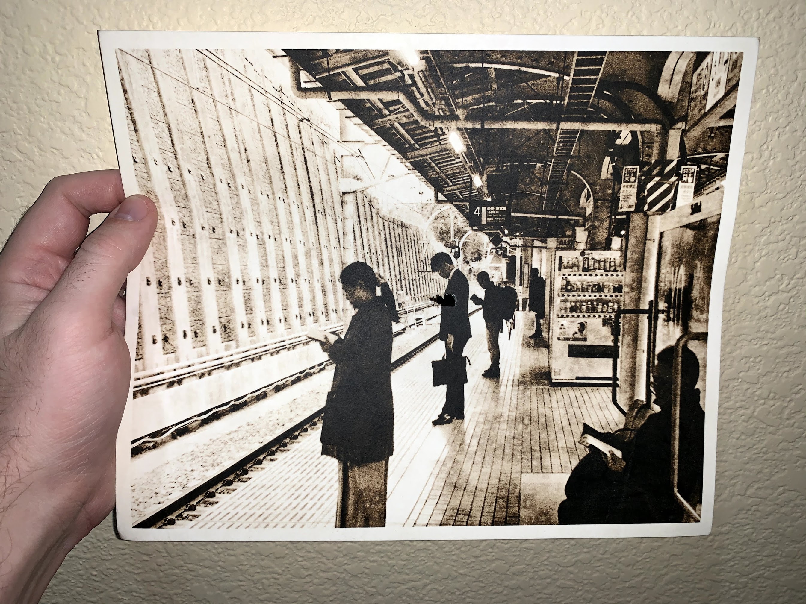

In my experience, some papers won't have much color until after rinsing
Also, this is an example of the blue and purple color possible. Another lith print, but on Ultra.EDU Ultra RC paper. Originally was fairly neutral tone

With closer examination of the prints, the sulfur sludge is definitely a problem. I rinsed these prints extremely well under running water and still got a pretty significant amount. It can probably be wiped off while wet with a damp cloth or something. The sludging will give a slight yellow cast to the image if not wahsed off (along with a powdery appearance) Of greater concern though is that some prints had iron rust contamination embedded into the emulsion. I'm not sure if this is some reaction with the minute amounts of iron in my tap water, or if there is some contamination in my trays (I did iron based experiments several months ago). The threads of iron begin as being pretty much invisible, but after dry they oxidized to form rust orange fibers. Based on previous experience with this problem, it can't be washed out or removed and will turn blue if dunked into a ferrocyanide bleach.
To me, 45 minutes seems like a very long time. I think the longest I did toning was 5 minutes, but maybe if I had toned for a very long time I would've converted the blacks of the image to sepia tone. I definitely the overall color spectrum a bit better than normal sulfide sepia toning, and rather than removing density by bleaching it, it seems to keep the same density or slightly increase density.

@earlz: I did check the colors of this print with GIMP, and the color of these sky scrapers is plain red. I did do a reference measurement of the print borders, too:
  • print border: R = 229, G = 225, B = 233, that's actually a tiny bit purple
  • right most sky scraper: R = 209, G = 197, B = 196, that's plain red
  • dark windows of right most sky scraper: R = 184, G = 172, B = 171, that's plain red
  • left most sky scraper: R = 223, G = 212, B = 213, that's plain red
  • bright part of the trees to the left: R = 201, G = 179, B = 172, that's plain red, with a tinge of orange
One of the things throwing this off is iphone picture color balance is kinda crap, and that I didn't notice until after that it had a layer of yellow scum from the sulfur. Wiping it off a bit revealed much cooler tones. When the print was wet this scum was transparent. I'll have to rewash the print at some point and do a proper flatbed scan of it. It's hard to replicate exact A-B results since I only get the cool colors from lith prints, and not always even on the same paper. The blue color appears to come up the most when yellow staining is present (I believe a combo of hydroquinone staining and general fog). Either way, the SO2 problem is real and I don't have a well enough ventilated space to really feel safe (or at least not highly annoyed) to do much more with it. I expect it's basically a hypo alum type toner accelerated by the bleaching and reducing effect of SO2 in solution. I suspect the blue color is not from sulfide conversion, but rather from some plating effect. I've also noticed afterwards that some prints have a very subtle yellow stain that does not wash off. Either way, look forward to hearing back from people who want to replicate this and do have enough ventilation for it to not drive them insane (the SO2 smell is particularly annoying because it gets stuck in your nose and it's all you smell for at least an hour afterwards even when in fresh air)

@earlz : Since I was not sure about the correct color balance, I did provide numbers for the image borders. If anything, these frame borders were blue/purple, definitely not yellow. If we bring these frame borders to perfect neutral, assuming that its hue comes from whatever scum deposited on the print, then the rest of the image will turn red/orange.
