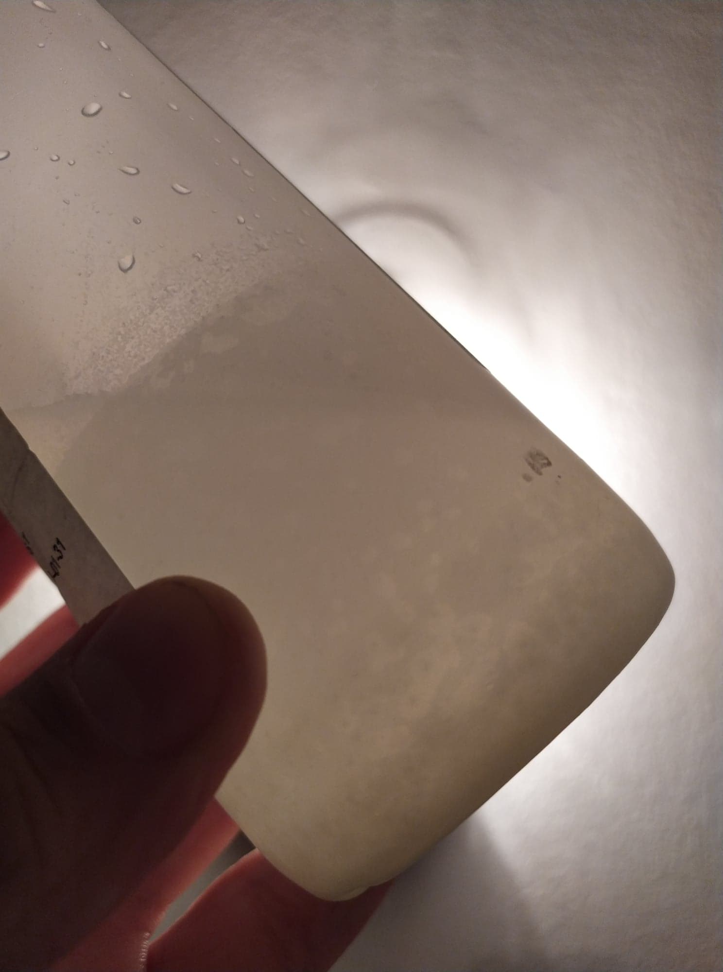

I have FomaFix with expiration date of february 2021, the bottle was opened some six months ago, when I wanted to use it I saw the sedimentation as seen it the photo, it collected on the walls and some more (and in thicker layer) on the bottom of the bottle and also floats around in the fixer. I am not going to use it, of course, but am interested in what went wrong. I kept it in the darkroom which is in my basement, temps this year ranged from 20ish to 30ish, never below or above it.

All acidic fixers eventually precipitate sulfur and this is likely what has happened. The bottle walls are covered progressively with sulfur crystals, some of which float in the liquid.
I put my fix through a tea strainer to remove crystals. Haven't had any short or long term fixative problems doing this.
So it is usable, after all? My logic was, when I saw it - it is cheap and no point in saving very small amount of money and being prepared to mess up whole negative over it
if it's colloidal sulfur no filter will do...
Correct, don't use this fixer. Colloidal silver will eventually attack the image silver.
@Boris Mirkov : the fixer had expiration date a few months in future, but this expiration date only applies to unopened bottles. I you don't use fixer very often, think about getting neutral fixer, these have much better shelf life, both as concentrate and as working solutions.
