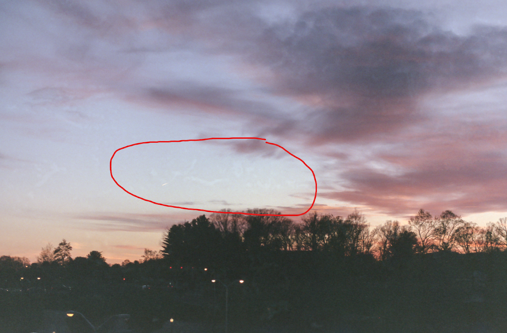

Hi there,
Recently I started shooting films and scanning my negs using my EPSON V600 scanner. However, after working with a few rolls of color negative (fuji c200 and c400), I found some weird marks which look like transparent worms wriggling on my scanned images. They made my digital scans awful to look at and I have been getting this problem with almost every color neg roll. Attached are some scans with this issue.
I did some searching on Google and doubt if it is caused static discharge. However, I am not sure about this and want to know if someone here has an idea of what's going on with my negs.
Thanks!
Chenhao

I would be inclined to say it's not static; looks like the film got humid and stuck together.
1. Was the film fresh?
2. How was it stored before and after being exposed?
3. How long before processing after shooting?

Can you see the marks on the (magnified) negatives themselves, or are they a product of the scanning process?

Is digital ice turned on? Sometimes when scanning a dirty negative, the dirt and dust removal process can produce artifacts like this.
The patterns seen on your scans follow the general shapes I would expect with fibers stuck on the negative.
Try cleaning the negatives and re-scanning, or turning off digital ice.
Yeah, these rolls are fresh and I sent them immediately after I finish shooting (max. 1-2 days after exposure). I store unexposed rolls in the fridge and keep 1-2 rolls at room temp in case I need them.
That's a good point, my loupe is on the way and will be delivered soon. I will inspect these frames again to see if there are physical damage to them.
------- update:
I just checked the "bad" frames of my neg. It turns out that there is something on my neg: transparent marks (looks like water spot or chemical residue from the process). I wonder if I can clean it up with alcohol or distilled water. By the way, should I tell this to my processing lab?
Yes, I did turn on digital ICE during scanning. Let me try it again without that.
The last step of the C41 process is Stabilizer. The Stabilizer is similar to PhotoFlo. Isopropyl Alcohol should be safe. Distilled water is fine to mix stabilizer or photoflo in but I would not use it by itself on color materials.
Show the bad negatives to the lab before cleaning.
Caution - Stabilizer is more than Photo-flo or Isopropyl Alcohol - it also includes a bactericide (sp). If you re-wash a colour negative or slide, you need to re-stabilize it as well.

1) delivered to you and stored in flimsy plastic sleeve
2) dirty chemistry (Ice only deals with surface stuff).
For 1), I just asked them to "develop only" for my color negs. As a result, processed negs are returned as a curled roll (not cut at all) in a canister (which was for 135 film rolls).
I guess 2) is the real cause of this, I should have a talk with them.
