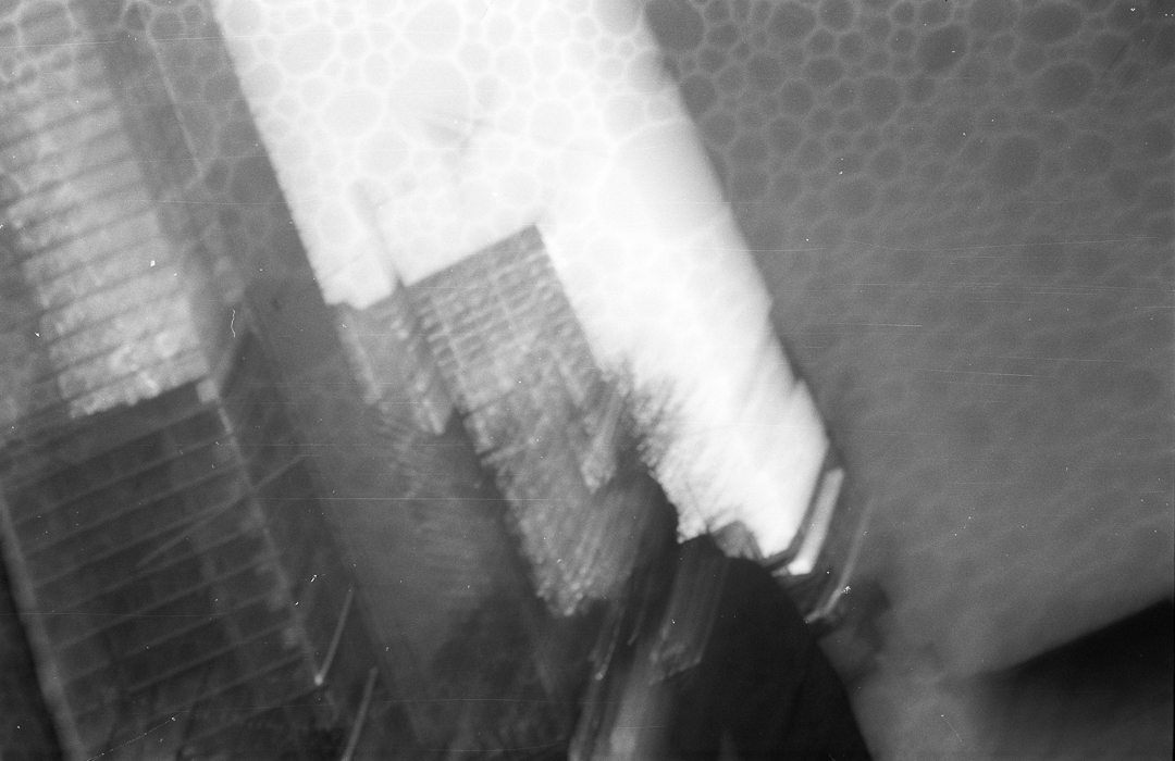

Hello everyone, I have been developing my own film for more than a year now and I have never seen anything like this on the negatives. I don't think its reticulation but I also don't have any idea what it could be.

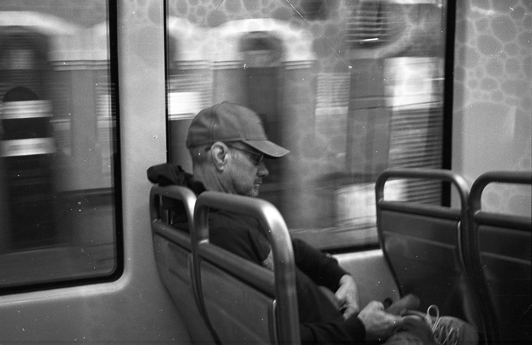

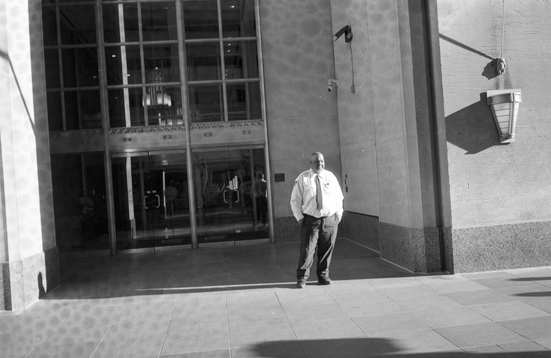

The surprising thing is the weird pattern on the film negative shows on some frames within a roll and other frames are completely clear except from the usual dust.
All inputs are appreciated.

I'm assuming this is 35mm negative film, but not sure it really matters. There's what seem to be bubbles on the film surface-- maybe developer is foaming slightly sometimes? Try less vigorous agitation, make sure there's plenty of developer in the tank. It might help to know what developer you use, and if you do multiple rolls. Just spitballing here- even though I'm a Caffenol guy and it does foam during mixing, I've never had that foam make an appearance on my negatives (maybe I'm just lucky).

I've had that happen and, like @nosmok says, it's bubbles.
When it happened to me, it was because the chemistry didn't fully cover the top roll in the tank. In my case, this has to do with how the tank I use is constructed, I have to make sure that the film reels are truly sitting at the bottom of the tank and not on a protruding plastic bit at the bottom. That might be the case for you or you might just need to make sure to use the right amount of chemicals.

+1 on the foam/bubbles. Most common causes have been listed, and we've probably all done it at some point. In my early days I was too enthusiastic with the agitation, and in more recent years I've had not quite enough developer to cover a tank full of multiple films. Similar results.

It's indeed foam and it's nearly always related to using insufficient developer.
@tijani, what kind of developing tank do you use and how much liquid did you put in?
I use the Paterson tank and the Paterson plastic reels. For this batch, it was done in the 5 tank reel but with just 3 reels loaded.
