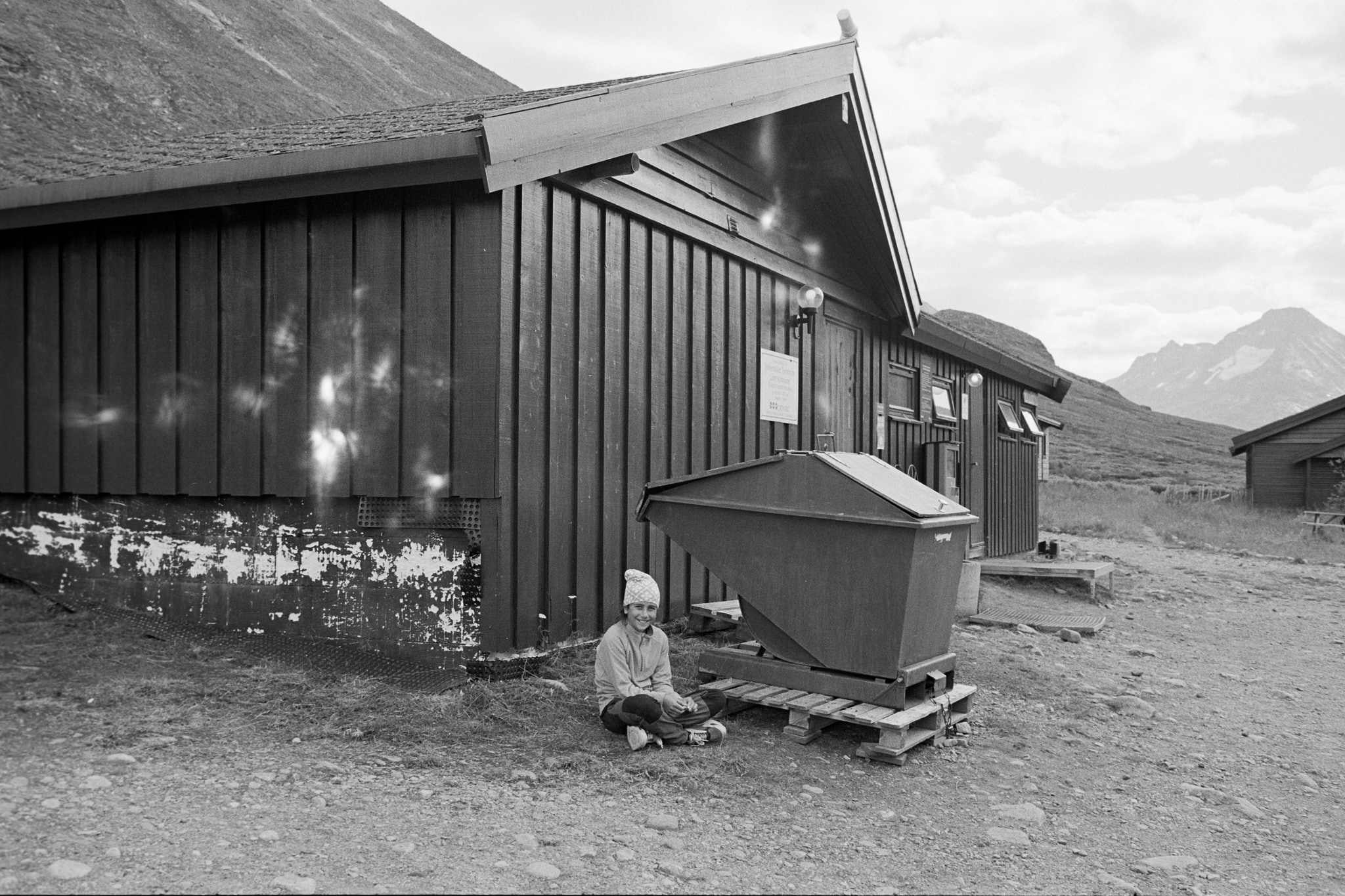

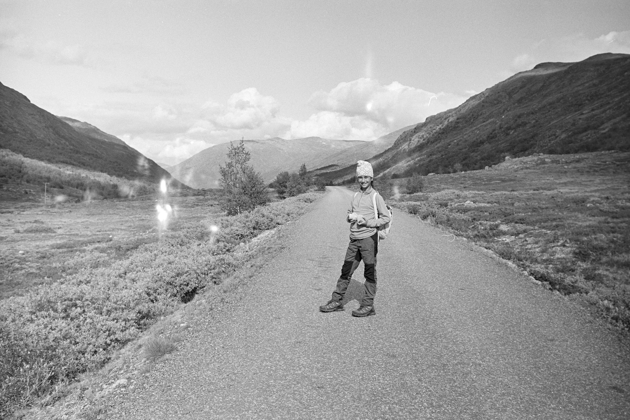

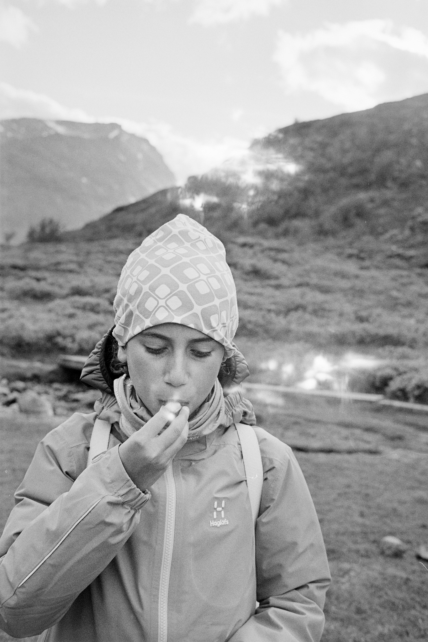

I shot a roll and 6 out of 36 images had these strange light leaks / flares - other images with faster and slower shutter speeds looked find. The lens seems clean, I've had the camera over a light table to see if there might be a hole in the shutter (Leica M2) but I did not see anything. Has anyone seen this before?

Since the "stuff" appears the same in two very different scenes, it's not something in the scene -- like reflections.
If it is the lens, it should show up in all of the images.
I'm not familiar with the shutter on the M2. If it is a horizontal cloth shutter, it has TWO flaps, and the problem could be in either of them (opening or closing).
If you can't visually see any problem in the shutter, I'd run a test roll against a grey card or mid-tone wall -- with the camera on a tripod. Use the same lens, and take exposures at each shutter speed and see if it only shows up at certain speeds.

It was the shutter. I noticed it when I sat in a pitch black closet. The holes are tiiiiiny.

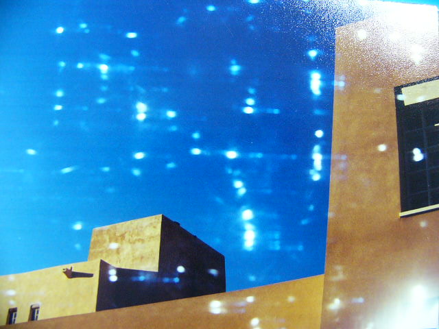

Upside is this was very easy to diagnose, and the repair can be easy. Either 'paint' over the pinholes with carbon black paint:
or get the shutter curtains replaced. I've used the paint on a Zenit and it worked great. Thing is, your M2 is obviously old, and so it may need new curtains anyway. yyecamera.com charges $185 to replace them.
