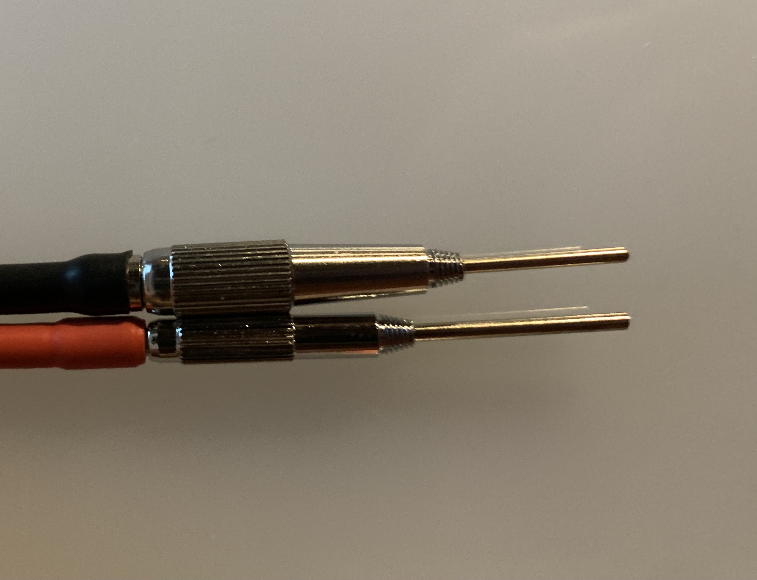

OK. based upon countless favorable mentions, I bought a Gepe pro 40" cable release. To my shock and dismay, the plunger is too big to fire my Fujinon C 300mm f8.5 shutter. What the actual heck? Modern lens not working with a modern release? My lesson for today I guess is to pack every cable release I own for an outing. (Or to test the dang thing at home) has anyone else found a new Gepe release to be too big for a Copal 0? Does the 40" release have a larger diameter plunger than a shorter release? It fires my little Wollensak in the Alphax shutter just fine.

Wollensak shutters use a "long throw" cable release.
The cable release sockets are also larger on the Alphax/Betax #3, #4 & #5 shutters, so regular cable releases screw in farther than on other cameras.
I had part of the threaded-end of a regular cable release snap off in a non-Wolly shutter (an unfortunate accident), and I was still able to get the remaining threads into a Wolly shutter and it worked.
Maybe that's the issue with your cable release?

It may not come across in the picture, but it’s plain as day to my eye. The Gepe pro release (red), has a larger diameter wire inside. The black release (unknown maker) trips the Copal 0 on the Fujinon just fine.
Oddly, the camera attachment end and pvc housing are both bigger on the release with the smaller plunger wire.
*not the mount threads, just the overall bits.

Interesting! 🧐
I have to test my cable releases before a shoot to make sure they fire my Alphaxes & Betaxes.

And you thought things like cable releases were completely standardized!
They aren't.

I knew about different overall throw lengths but good grief!
The best grief is good grief :whistling:
And we haven't yet touched on different thread shapes and pitches :smile:

For the sake of argument; lenses designed for 4x5 and larger, post 1953 manufacturing, and cable release maybe 20-25 years old. there shouldn't be that much variation, right?

Don't blame Fuji. But less than ideal cable releases abound. In fact, it's hard to find reliable ones unless you know what to look for, and where. What you bought looks more like a NASA rover probe to break through the ice on Titan. Cable releases weren't just designed for lenses, but also studio equipment. This is also the age of untested generic imports. I wouldn't buy a single cable release our local camera store offers, even though they're otherwise doing a good job. I can't use Gepe cables reliably on any of my own cameras or lenses. Next time, bring your lens itself into the store and test. Internet purchase? Good luck unless it's something you've had prior satisfactory experience with. I have quite a few "wish I hadn't ordered that" cable releases lying around.
I hunt for the silver Minolta ones.

I added an edit to the thread title. I have one of the standard length Nikon cloth releases that seems to work on everything. The other pvc coated version I have works well on almost everything too. The red gepe unit will hang around as the action feels nice and smooth. I'll just have to remember it will likely not work on Copal 0 shuttered lenses. I sourced it from B&H btw.
