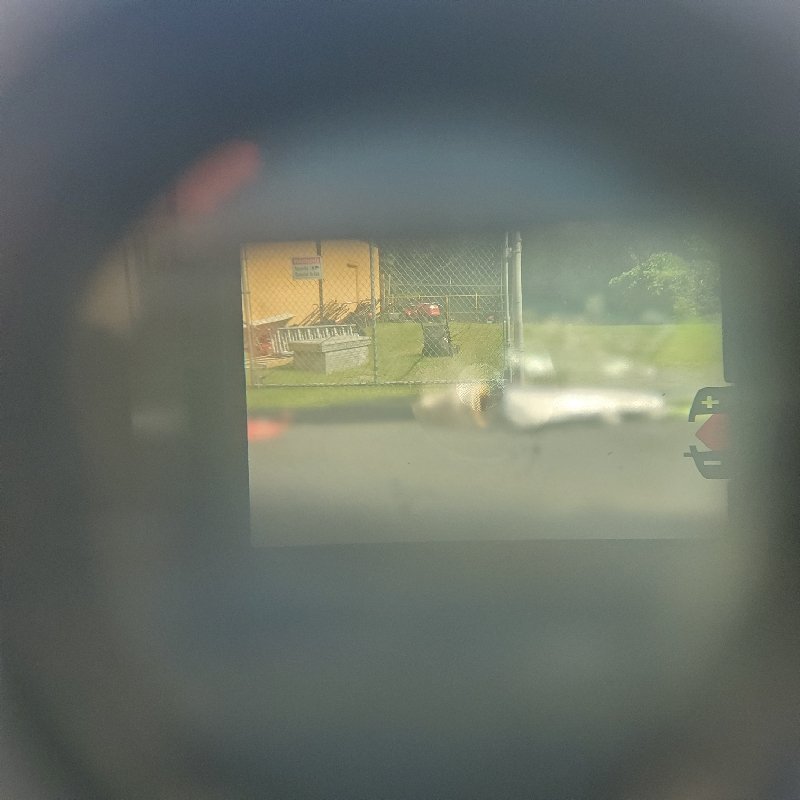

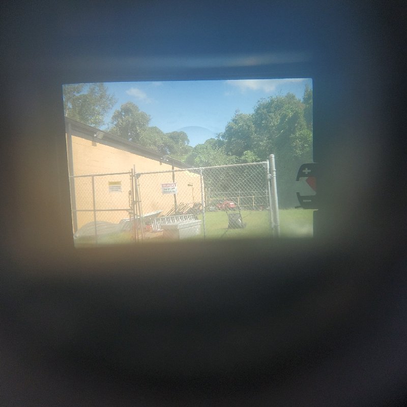

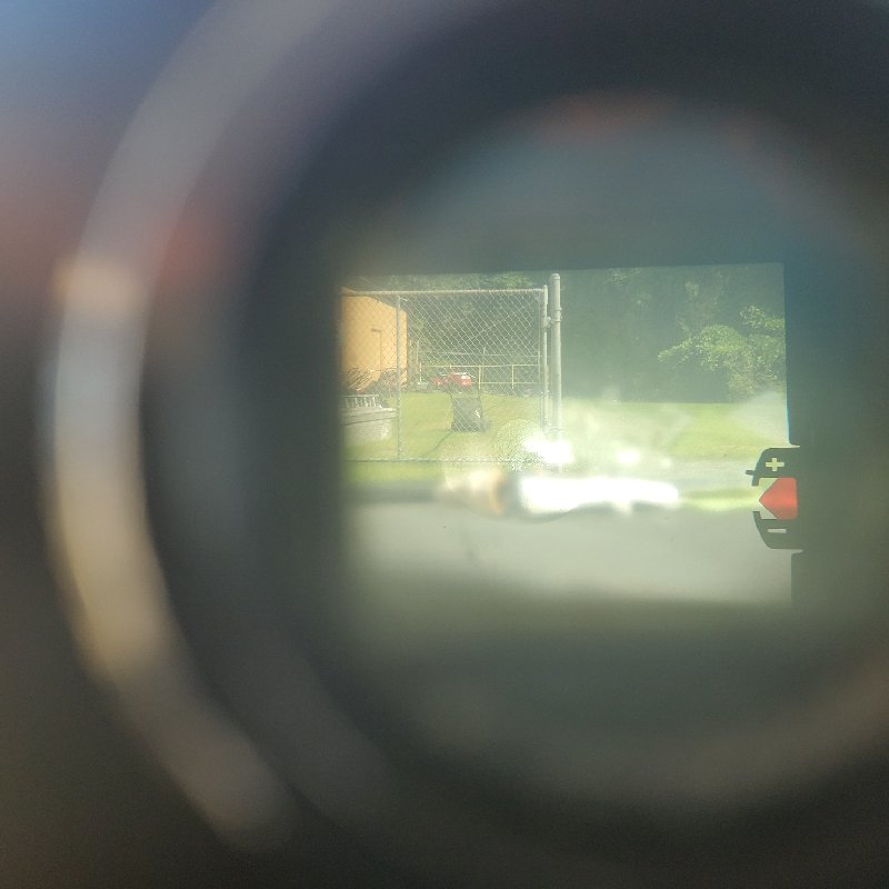

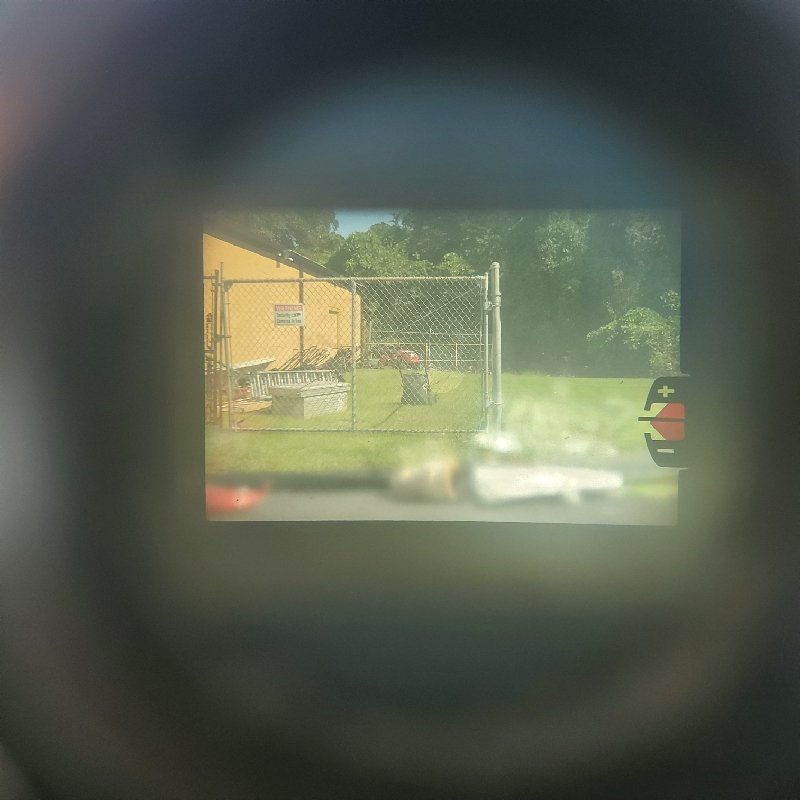

I have pictures of the viewfinder with the flag and the needle in various positions taken with my phone. I was surprised... not all viewfinders come into focus on my phone camera. I'll post them once I'm at a phone charger.

Here's the pics. This is what it looks like when you rotate down past the shutter speed where the flag comes out. They may not be in order. The position of the needle goes from low to high in steps.
