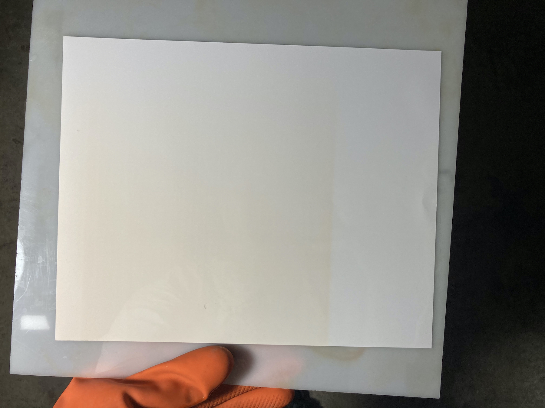

Hey guys,
I've been printing with a Thermaphot ACP 200 for a couple months now, and when I first started using it I had no issues whatsoever. A great little machine.
However, now a really strange cast has shown up, where about 3/4 of the print has a strange orangey/magenta cast to it.
I've attached a photo of a blank sheet of paper that I fed through the machine.
Any help or ideas would be super helpful!
Thanks
koraks
Nov 29, 2018
23,651
Europe
This is light fogging. How do you store the paper prior to use? I find that some of the black plastic envelopes aren't entirely light proof - which is just one of the myriad possible causes.
pentaxuser
May 9, 2005
20,039
Daventry, No
So presumably the OP changed from one set of papers which were OK to another that had a different storage method? So OP have you changed from one black plastic bag to another or otherwise made a change which affects storage?
Indeed what changes in total have occurred since the paper was OK? Logically there has to have been a change of some kind to account for the problem.
Thanks
pentaxuser
