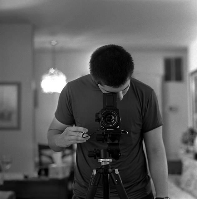

I actually like it, but I was wondering if this was normal, or if it means something is on it's way out...

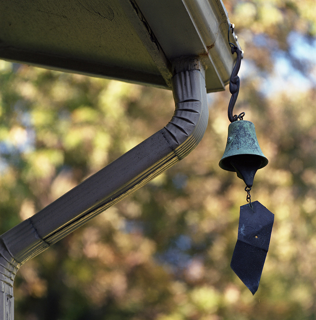

and to a lesser degree here;
it doesn't affect exposure, but I haven't tried chromes yet.

First picture gives the answer, as you can see in the lens your shutter blades are sticky and the shutter is not fully open, this gives a strange tornado like shape to any out of focus light (it is actually the shape of your shutter).
The problem is less obvious with smaller apertures and it could be disappeared at f:8 or f:11.
And yes it does affect exposure.
Unfortunately you have to have your lens CLA'd.

yep, I'm agreeing with antmar on this one. you can see the "ninja star" shape on the specular highlight on the chandelier.
some of the lenses Zeiss made for contax/yashica mount actually feature this shape but those lenses do not contain shutters.
looks like the shutter blades aren't opening fully and dragging/sticking (and probably the aperture blades as well)
try taking the back off, open the aperture fully and fire a flash and you'll see the shape more pronounced.
the effect will most likely change with differing shutter speeds also.

I'd say aperture blades as the shutter blades are moving during the exposure and the aperture blades are not moving. It likely needs CLA.
The aperture blades won't make that shape. The reason the shutter blades are sharply defined in the picture is because they did not open fully and are stuck partway until they close again.

You are using the focal plane shutter on that camera? I think that is the only way (besides flash) to get a good picture of the lens shutter blades as you have done. Maybe they are stuck like that. Have your tried firing the lens shutter? Does the lens shutter work?
