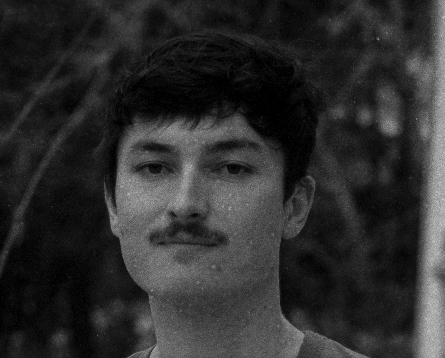

Hi,
I'm wondering if you knowledgable folks could hazard a guess as to what went wrong here? Acros II developed in Rodinal 1+50 processed at 22.9 degrees with appropriate time compensation. JOBO rotary processor. Scanned with a Nikon Coolscan 9000 using Vuescan. No sharpening applied.

Does the negative show these defects either to the naked eye or under a loupe? If so is this a 35mm or 120 film?

Yes the negative shows the defects. It was 120, and yes retina_restoration it was past its expiration date by 2 years (it was freezer stored).

Does Vuescan apply automatic sharpening?

I seriously doubt it has anything to do with the film itself being a tiny bit past date. In fact, Acros II has been around only briefly. I've shot original Acros 20 years past date, not even frozen beforehand, with complete success - (not that I recommend doing that). And I've processed older120 roll Acros thawed out after a number of years with zero issues. Perhaps there was some crud clinging to the walls of the processing drum, which broke free during processing and contaminated things. Clean your drum and reel well, try another developer, and see what happens. And use the lowest RPM your processor will allow. Does the developer get frothy, the way you do it?
The other possibility is that, being finished by Harman now, rather than Fuji, some of their own defective backing paper was involved. You'd have to inquire about that.

Yes that might be it re: the backing paper

With respect to the developer, I processed Kentmere 400 in Rodinal 1+50 straight after and it came out fine, so my guess is it’s something to do with the film rather than the processing method or tank.

No one will agree with this but this is caused by the formation of condensation. Likely at some point, this film was removed from a fridge or freezer and not allowed to come up to temp properly.

Thanks. That might be it. I gave it some 6 hours out of the fridge before development. Maybe not enough time.

6 hrs would have been plenty, provided the room itself wasn't cold, or the film packing seal itself broken earlier. Condensation probably would have produced bigger foggy spots.

Backing paper problems - both from backing paper that is problematic and backing paper which is not known to be a particular source of problems - are relatively more common now.
Older film that has been frozen is likely to be more vulnerable to those problems.
With 120 film, cool and dry is probably wiser than frozen.

Wow. Is that really the case? I keep all my expired 120 film frozen and all my in date film refrigerated. Should I move the frozen stuff out of the freezer?

I don’t remember how long I had it thaw before using it but likely overnight.
One thing I forgot to mention about this roll is that it was a “fatty” I.e. my GA 645 did not wind it on properly tight so when I took the film out it was not wound tightly on the spool. This led to light leaks showing after I developed it and I’m wondering if this looseness also allowed moisture to enter when I put it back in the fridge awaiting development.

Just a quick update on this:
I ran another development. Same batch of Acros II, shot at the same time. Developed it again in Rodinal in my JOBO.
No issues with this one.
So I think it was likely:
1.Some issue with that individual film or
More likely:
2. Condensation from putting it back in the fridge with the roll not being tightly wound on the spool
Thank you for everyone who has provided ideas on the thread. Really appreciate the help!

Think what you want, but there has been plenty of evidence to support the idea that 120 format films manufactured/finished by Harman/Ilford will show defects like the above if the film is past its "best before" date. The modern backing paper (and inks) will eventually interact with the modern film emulsion and substrate, and start to leave marks and mottling, visible once developed. Many of us - myself included - have seen this happen.
The solution is to avoid caching more film than you can reasonably expect to use before it expires. Refrigerated (in tightly sealed containers) is fine, freezing isn't necessary. 120 films stored in a warm environment (about 65F or thereabouts) will start to degrade before the expiration date - also something I have observed myself, with FP4+ and others finished by Harman (Pancro 400 and Neopan Acros).
Use it before you lose it.

The modern backing paper (and inks) will eventually interact with the film emulsion and start to leave marks and mottling, visible once developed. Many of us - myself included - have seen this happen.
It is probably important to reword this as "The modern backing paper (and inks) will eventually interact with the modern film emulsion and substrate and start to leave marks and mottling, visible once developed. Many of us - myself included - have seen this happen."
It isn't just the backing paper that has changed, and it is the interaction between everything that creates the problem.
For 35mm, that makes some sense, but for 120 and its backing paper, cool and dry - not refrigerated or frozen - is probably better. The backing paper interaction is unpredictable.
