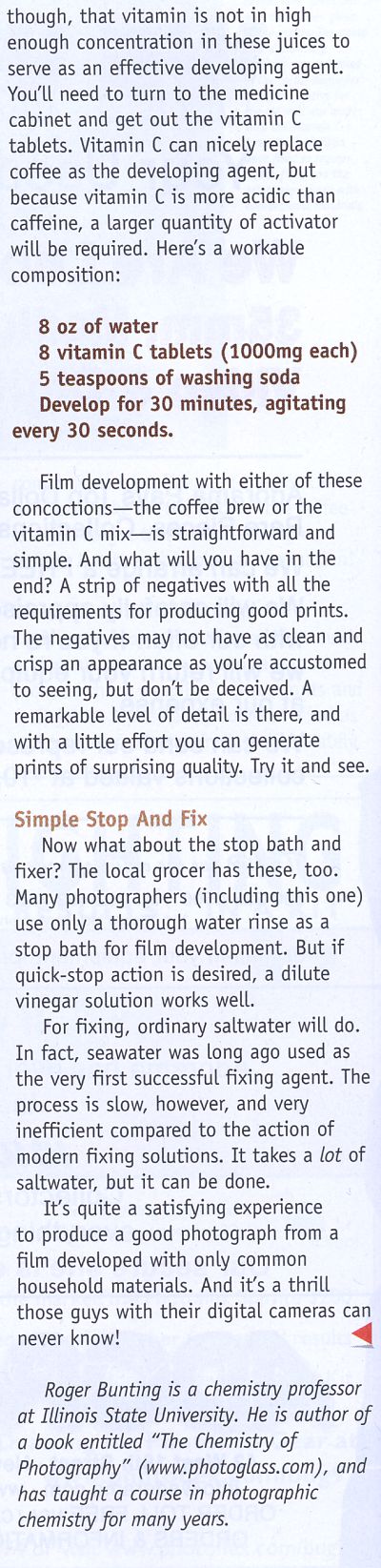

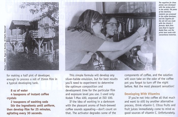

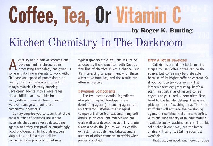

Looking at https://web.archive.org/ I found a "Shutterbug" article from September 2003 with a homemade developer formula. Will it still work?
Or the coffee is no longer as it was before...
Buscando en https://web.archive.org/ encontré un articulo de shutterbug de septiembre de 2003 con una formula de revelado casero . ¿Funcionará aun ?
O el café ya no es como era antes...

That's definitely an oldie.
While those formulas do work, they've been rendered really obsolete by more modern ones that can be found in the caffenol cookbook (https://www.caffenol.org/2012/11/27/the-caffenol-cookbook-bible/)
Thing is that the ones in Shutterbug will tend to produce low contrast and high fog, things that have been pretty much resolved in the modern formulas.
Also, years ago it's been found that it's not the caffeine in the formula that develops the film but the caffeic acid.
If you take some caffeine pills and use those instead of the regular brown stuff, you get a blank film. So the article is a bit misleading.

And I forgot to add it stinks like rotten fish too
That, I must admit that it's not the best smelling developer out there. And you should try it with crushed blueberry vitamin C tablets! These things might taste good, but once dissolved, strained and mixed with the sodium carbonate, they can make you lose your lunch.
But if you use the flavorless ascorbic acid crystals that are recommended, it just smells like yesterday's coffee.
