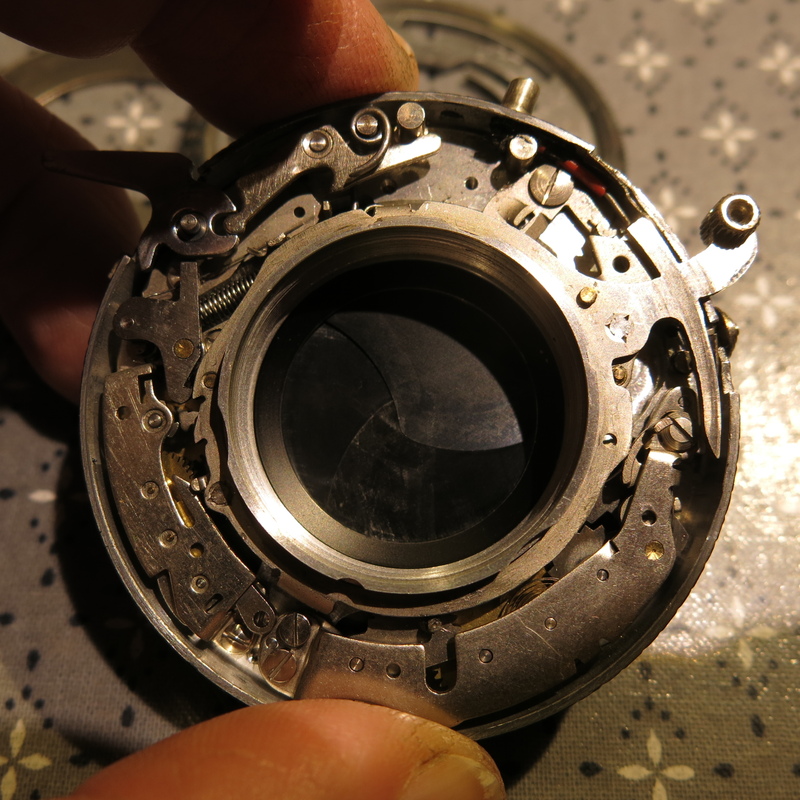

I recently repaired a messed up 531/2 Super Ikonta. I even managed to get the rangefinder working correctly! That was more than I really deared hope for. But I believe the shutter has been tensioned for a long time, because the main spring is probably weaker than when new. This makes the 1/1 run slow at around 1.7 second. (The 1/100 runs fine, which I think tells me that when there is no resistance other than the basic chain from the spring to the blades, the spring is just strong enough to drive it.)

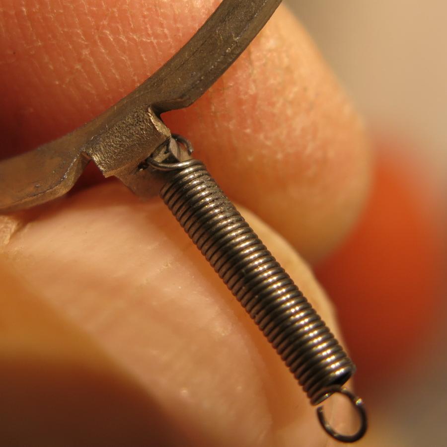

Attached picture shows the (same) spring from another similar camera/shutter that runs fine on all speeds. I could perhaps try moving that over to the Super Ikonta. But is it possible to shorten the original spring slightly to make it stronger? Is there a big risk of breaking it?
shutter springs have been tested in depth. Hasselblad determined that their lens shutters can be left cocked for 30 years or longer without losing functionality. A 1s exposure running for 1.7s is no issue; it might even compensate for reciprocity failure! I suggest leaving as is and congrats for fixung the range finder.

As Ralph says, 1.7 isn't that big a deal. Most likely the cause is dirt and such in the slow speeds escapement. Or the escapement mechanism needing to be adjusted. Faster speeds are often fairly close while slower speeds using the slow speed escapement show dirt and misadjustment.
I wouldn't move the spring. And I wouldn't try shortening the existing one. There is risk of breaking it if you try to cut off a loop and bend a new loop. Or you could bend the spring and put a crimp in it. Given the narrow channel it moves it, this is not good!
I would go shoot some film and see if the speeds are working for how you plan to use the camera.

What you show is called cocking spring in the official documentation. The main driver for actuating the shutter blades, with delay provided by the retard mechanism, is the main drive spring, 515 in drawing below.
Plus, if the "fast" (1/30 and faster) speeds are correct, there is presumably nothing wrong with the spring, otherwise they would be slow as well. I would rather look in the direction of the retard mechanism, maybe some dried lubricant.

I’m not familiar with the escapement mechanism of that shutter. It would take a significant weakening of the spring that powers the shutter to make a big difference in the shutter-open time.
It is more likely that the overly long shutter-open time is a function of something other than the spring force, most likely friction and drag at the pivot points of the parts involved due to dried and oxidized lubricant. This slows the motion of the parts compared to their behavior when new and freshly lubricated.
Simply increasing the spring force is not a solution to the problem. A clockwork-type camera shutter mechanism has many pivots or bearings, each capable of introducing additional friction as the lubricant ages.

When the shutter is uncocked the cocking lever is not fully at it's relaxed/leftmost position telling me it must have lost some tension.
Also, cocking it takes noticeably less effort than other similar shutters of the same size. That's why I itch to try to shorten it...!

The cocking lever being sluggish could be an indication that there is some deformation. Is it moving smoothly when the spring is not anchored?
I would spend make a few adjustments to see if moving the escapement will bring times closer before tightening the spring. Also confirm that there isn't something in the way keeping the ring from going all the way home.
And if these fail, and you are intent on snipping the spring, be sure to cut and bend in a way that preserves the orientation of the loop, etc. If you don't duplicate the present orientation of the lopp, the twist to have it mount properly could cause a rotation in the spring that causes a problem. All in all there are many of these shutters out there so you will probably be able to find a new ring if this one blows up.
On the 1/100 speed (and 1/30, 1/60), the main drive spring must move the shutter blades and overcome the inertia of the gear train in the retard (but without pallet). It is that inertia that makes 1/100 slower than 1/250. This is why I argued to leave the spring alone.
I wrote above:
Let me correct this. Maybe you are right in thinking the spring is weak, and someone in the past compensated for this by adjusting the position of the retard. Because the retard lever travels less at 1/100 setting that at 1/60 or 1/30 (or 1/50, 1/25, never mind) the compensation should be less effective at these "slower fast speeds", where the fractional change of travel from the adjustment would be less. It would help to reach a proper diagnosis if you would post measurements of all speeds. A complete assessment of the situation is in order before making an irreversible intervention.
