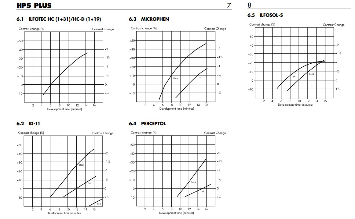

On the matter of dilution affecting development rate, I've attached some information that used to be in HP5+ data sheets - the Microphen/ ID-11/ Perceptol comparisons rather precisely demonstrate the stock/ 1+1 relationship differences for superadditive/ non superadditive developers (I suspect that the seemingly odd results for Ilfosol-S may have to do with the impact of high solvency on max density?). What is particularly striking is that stock Perceptol and stock ID-11 have almost identical development rate gradients (even stock Microphen is very close), but at 1+1, Perceptol has a noticeably shallower development rate gradient than ID-11. I imagine it would be fairly trivial to adjust Haist's D-76 variant at 1+1 to track D-76 at 1+1 - the question is whether to adjust metol or borax levels - on the understanding that it would probably significantly affect the stock solution development speed.
