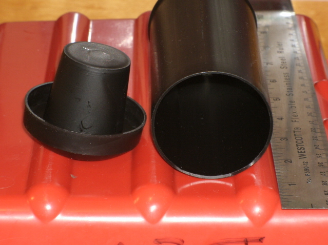

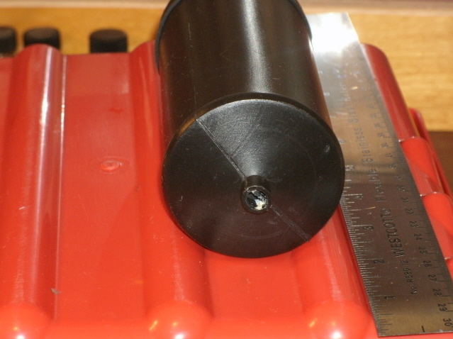

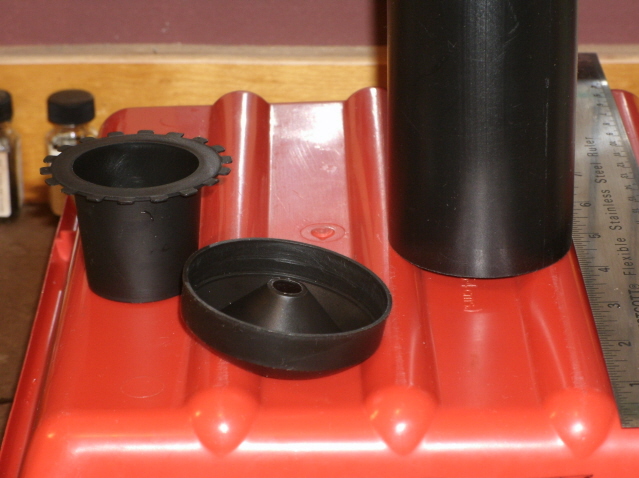

I acquired this when I picked up my Jobo, was in with the processing tubes. I looked at it for awile, then tossed it back in the box. A few weeks later, I listed some Ilfochrome tubes here, and while looking up instructions for their use, I finally figured out what it was. You have a couple of clues already.
Can you figure it out?
Make your best guesses, then I'll show the rest of the photos and explain.

It's an old 4x5 Cibachrome processing tube from way back when. Ilford marketed a 4x5 Cibachrome starter processing kit back in the late '70s to early '80s to let people try out the process at a relatively low price. The kit included paper, chems, the drum and i think a basic filter kit. If memory serves, the kit sold for about $21.95 US..

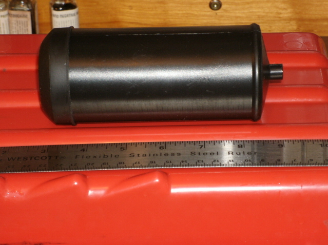

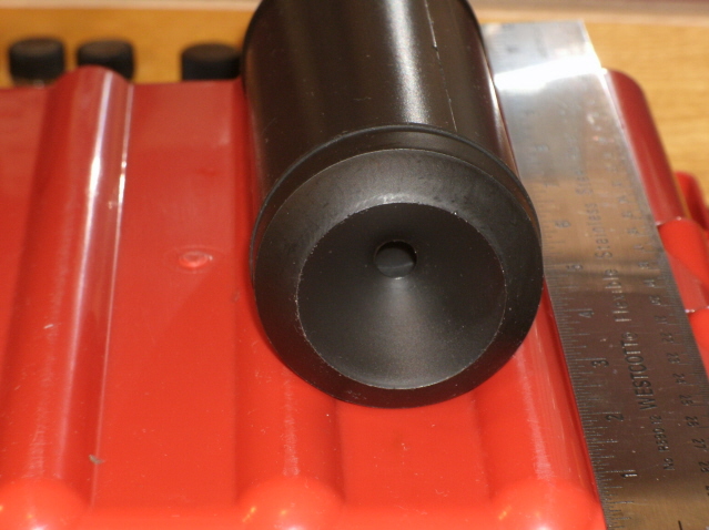

You are correct! It's a two sheet, 4x5 processing drum. It uses a whopping 40ml of liquid to develope a pair of 4x5 sheets of film. I souped a pair of Delta 400 4x5's in Rodinal 1+50 and, except for an overlap mark on one negative, obtained perfectly developed film!
Here is what is inside, and the result. It is the most perfect pack-along processor I have ever found. Pour 40ml chems in the female end(holding upright), carefuly lay on side and roll back and forth on a counter. When step is complete, just hold upright over the sink and let the chems drain from the male end, while pouring fresh chems into the female end for the next step. The fresh chems are held inside the internal cup until the tube is laid on its side.
How ingenious!

A small caution. Years ago I tried using one to develop film but the area where the cylinder transitions to the funnel was thin enough that light came through and fogged that area. I think it would have worked well in comparatively subdued light.
Neal Wydra

Now it makes me think I should keep the Ilfochrome tubes and try developing film in them as well. This is a dandy one shot quick check tank. There is a huge difference between 40ml in this and 850ml for taco method in my big plastic tank, and 1.5l in the FR tank. I still like my Jobo for more than one or two negatives though. This certainly appeals to the cheapskate in me.

After trying it for a couple of times, you may only want to develope one sheet per time. I had a problem with two sheets, overlap lines showed from not being extra careful loading.
