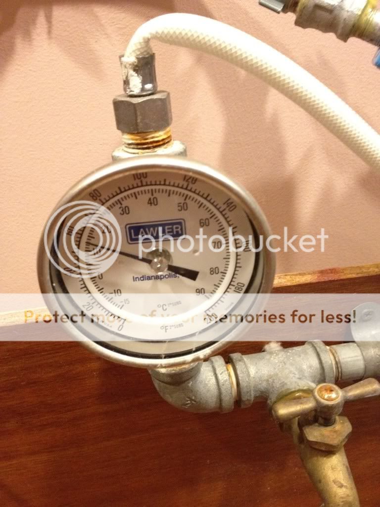

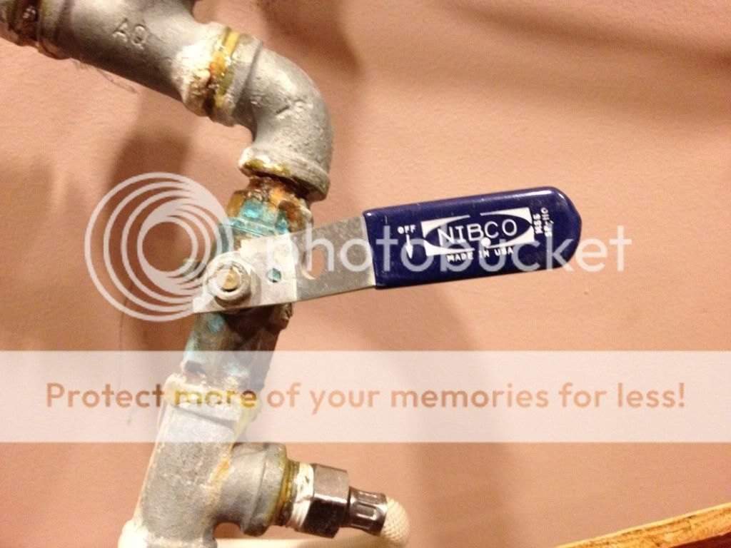

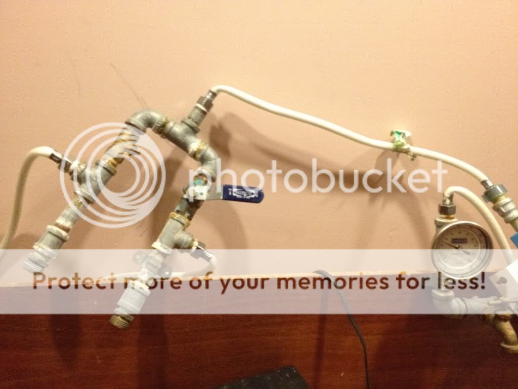

Have you considered a DIY solution? I am no plumber but could possibly build one after seeing the one I have.
The below is my sink, I have not hooked it up. The prior owner made it (although he was an engineer); it looks somewhat doable with manual regulator handles??? One for hot, one for cold, then a temp gague....

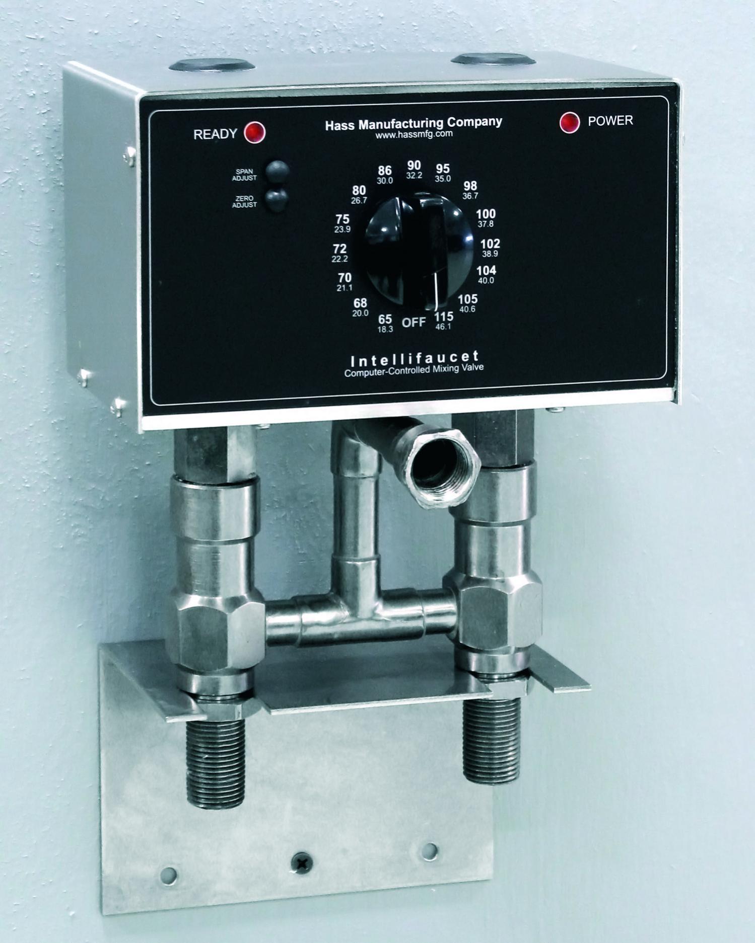

Haas Intellifaucet has low flow rate. And instant "right-on" temperature.
Not quite. I have one and really like it but it's not instant right on temperature. It takes it a few seconds to over a minute depending on the temperature changes of the incoming water. If the hot coming in isn't stable yet or the cold coming in isn't stable yet, it hunts around as the incoming water temp ramps up or down. You have to clear the "old" water in the house pipes first so that the incoming water in the hot and cold lines is relatively stable. Same would be true for the mechanical regulators.

this is my prime choice

I have a Powers Fotopanel (which works OK), a Honeywell - Sparco thermostatic mixing valve, and most recently a Haas Intellifacet that Ralph recommends. It is superb. I wish I had bought it first. I use the Intellifacet for precision control and the Sparco for less demanding control when I need two water temperatures at the same time. The Haas has a small transformer/power supply that plugs into a regular wall outlet. A GFI is recommended, but that is a good idea in a wet darkroom anyway. The Haas is worth every penny, IMHO. It has fixed temperature detents on the dial, but they can be adjusted if other temperatures are required, as can the linearity of the dial.

Got myself a Haas Intellifaucet a month ago and it was some of the best money I've spent for my darkroom. Just some plumbing and filtering involved and works like a charm. Temperatures are spot on and it's a major time and water saver.
