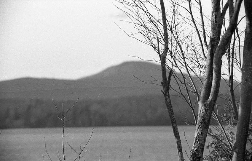

Hey guys,
yesterday I developped a few HP5 plus 35mm rolls using Xtol 1:1. I was using stock Xtol and diluting it 1:1. I think I made the mistake of adding the water to the Paterson tank and then adding the Xtol. I usually premix it in another bottle.
Do you think this caused the lines on the negatives?
Any tips would be appreciated,
Thank you,
Alex.

Yes the images aren't there, however you would run a high risk of uneven development and get marked edge lines were development was patchy if you added the water before the developer in the tank.

So am I to understand you were preparing your one part water with one part stock solution in the tank with film already loaded? If so, and the water line sat roughly where the line on your negative appears, then I would say, yes! Bad idea. Prepare your working solution in a separate mixing vessel before pouring it into the tank.

That's what I expected, it's the effects of less development below the line because it wasn't mixed well.

You added water with film in the tank? Why? We should have a sticky or some info on processing film on this site. If the emulsion gets wet before being contacted by developer the development process will be altered.
I see a line (likely a edge effec) but for the rest the same densities above and below that line.
EDIT: I realized that my laptop monitor is not able to reproduce such subtle shades. I had to set it at most awkward angles to realize a slight difference.
You know if this thread does not interest you or your not interested in helping rather than just pointing out the mistake, you can skip the thread. As someone else said, the development is pretty much the same under and over the line. There is some edge effect, but that's about it.
Yes, I added water with the film in the tank, I guess I just forgot that I was using 150mL Xtol with 150mL water and this would make a line half way up the negative. I've done almost all my previous development using rodinal and I did it this way, but because I was using using something like 290mL of water and then adding 6mL of Rodinal a few seconds later, it would make no difference (to me) because the level would be over the top of the film and it would be like a 10second presoak.
