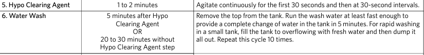

The advice above is generally good, but it is important to remember that the discussions respecting running water should be qualified in one major way. You don't need high volumes of running water. For example, for film, here is the Kodak recommendation:
A water flow that changes the water in a 1 litre tank in 5 minutes is barely a trickle.

Film does not require a long wash time, because very little fixer is absorbed by the plastic film base. Just immerse the film in water with Perma-Wash or similar product, drain, and repeat three or four times. The final time, do not use any wash-aid, but just add a few drops of wetting agent.This will use less than 3 liters of water!
