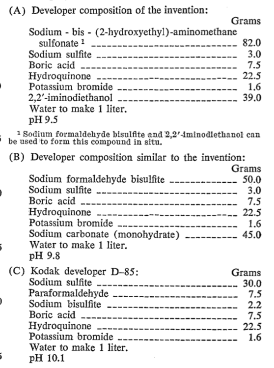

Not an answer to longevity of products in stock; Kodak was fond of
Formaldehyde-sodium bisulfite CAS: 870-72-4 which is used in their:
3,573,914 Patented Apr.6,1971
Thomas J. Masseth, Rochester,N.Y.,assignor to EastmanKodakCompany
Pasted Graphic.pngformulas from Kodak Patent
If you want to check further into the patent stack, these should be helpful. They also indicate some of the commercial mannerisms from the lith industry.
3,749,574 Patented July 31, 1973
3,799,780 Patented Mar. 26, 1974
4,025,344 May 24, 1977
4,598,040 Jul. 1, 1986

Lith developers can be as simple as
hydroquinone
sodium sulfite
potassium bromide [minute]
potassium carbonate
-- the stock/ tray life are exceedingly short --- mix and use every hour or so.
