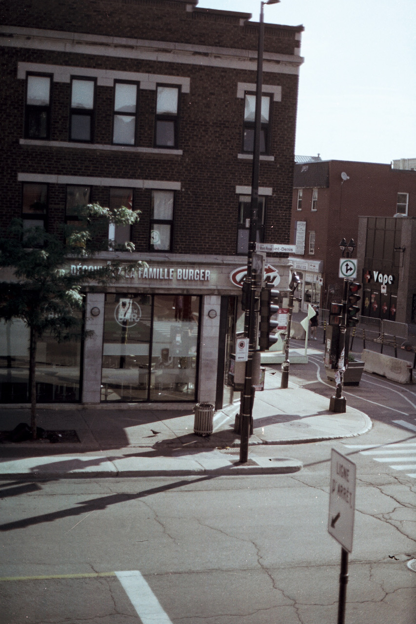

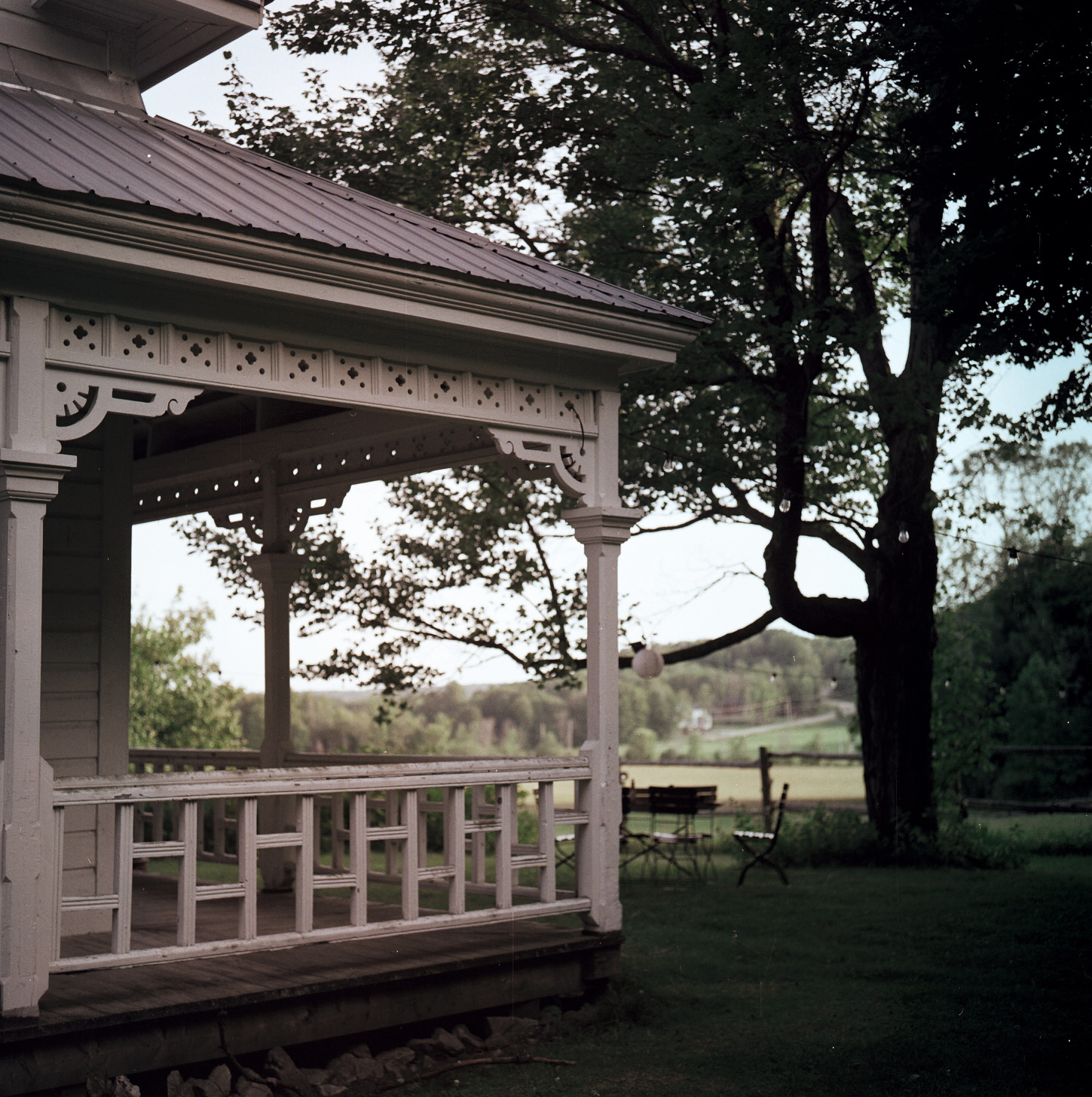

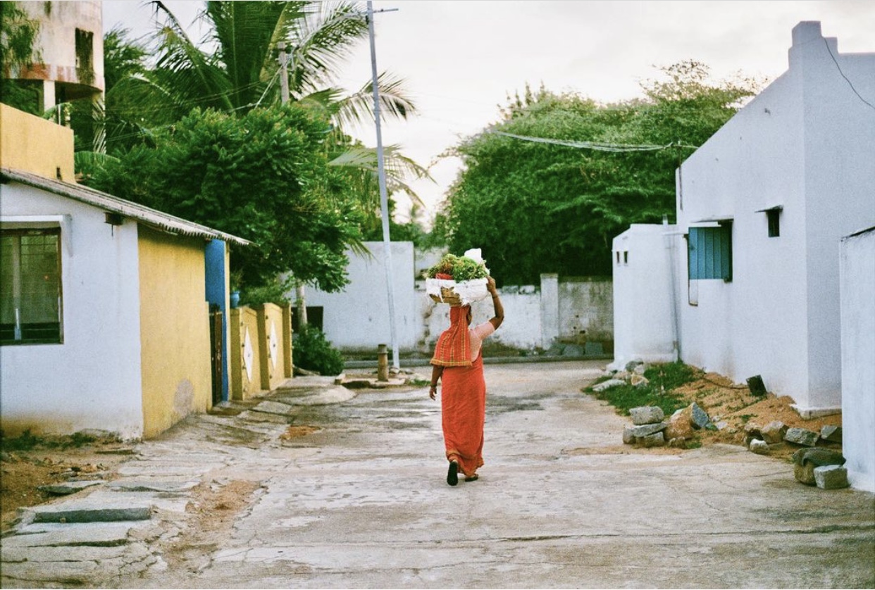

Hi everyone !
I am coming to you for advice regarding scans I have just received from a professional lab. All the scans are really washed out.
I shot different film stocks on different cameras, which brings me to think the issue is probably on the lab side (+ I have never experienced issues with badly exposing film, let alone 8 entire rolls...) : Kodak Colorplus 200 shot on an automatic point & shoot, a Nikon FM2 and Kodak Gold 200 on Rolleiflex
What do you think? Is there a way to "save" my pictures? Any advice as to whether there's a problem with exposure or development, or even scanning?
Many thanks for your help and advice
Lucy

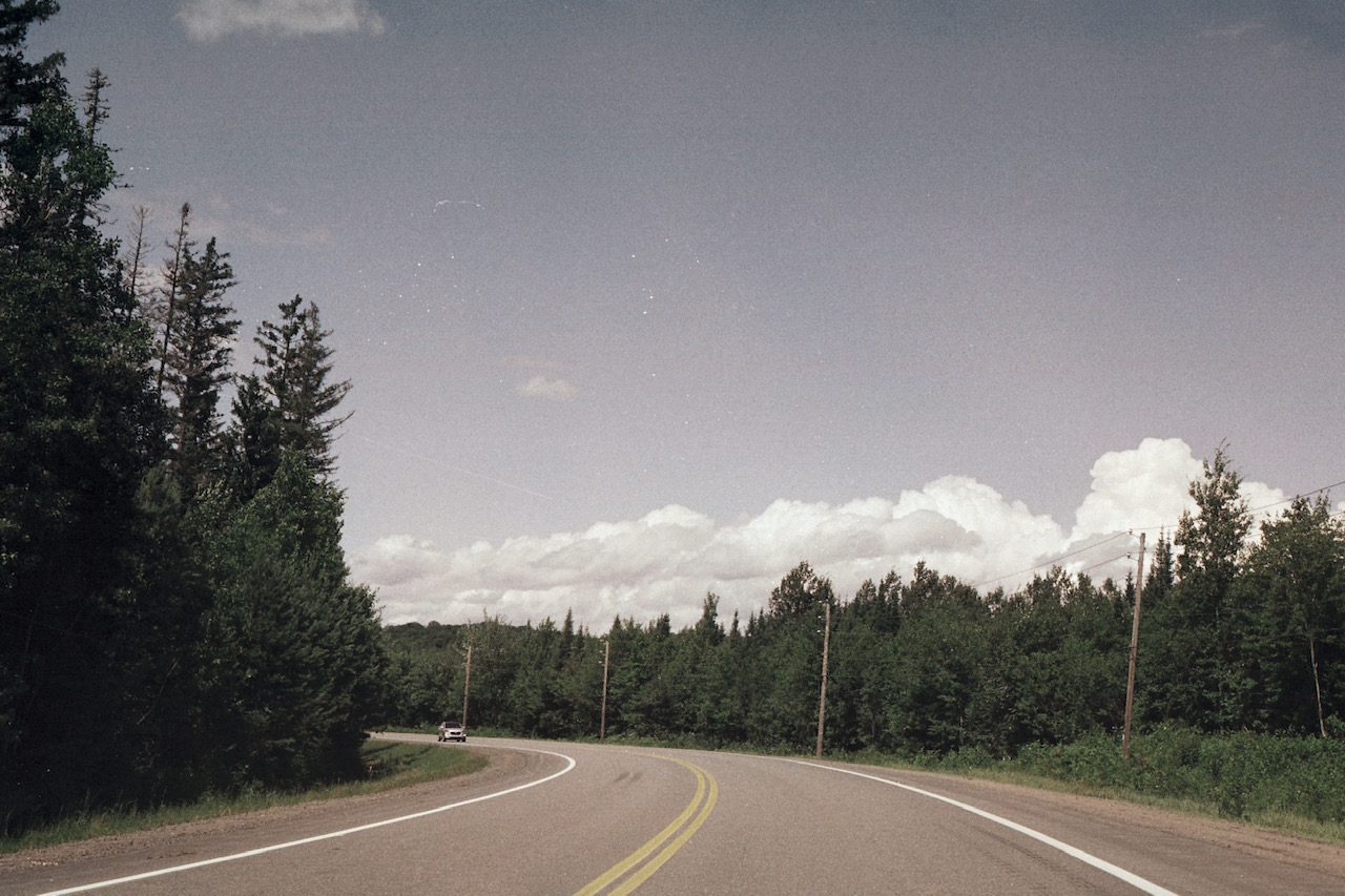

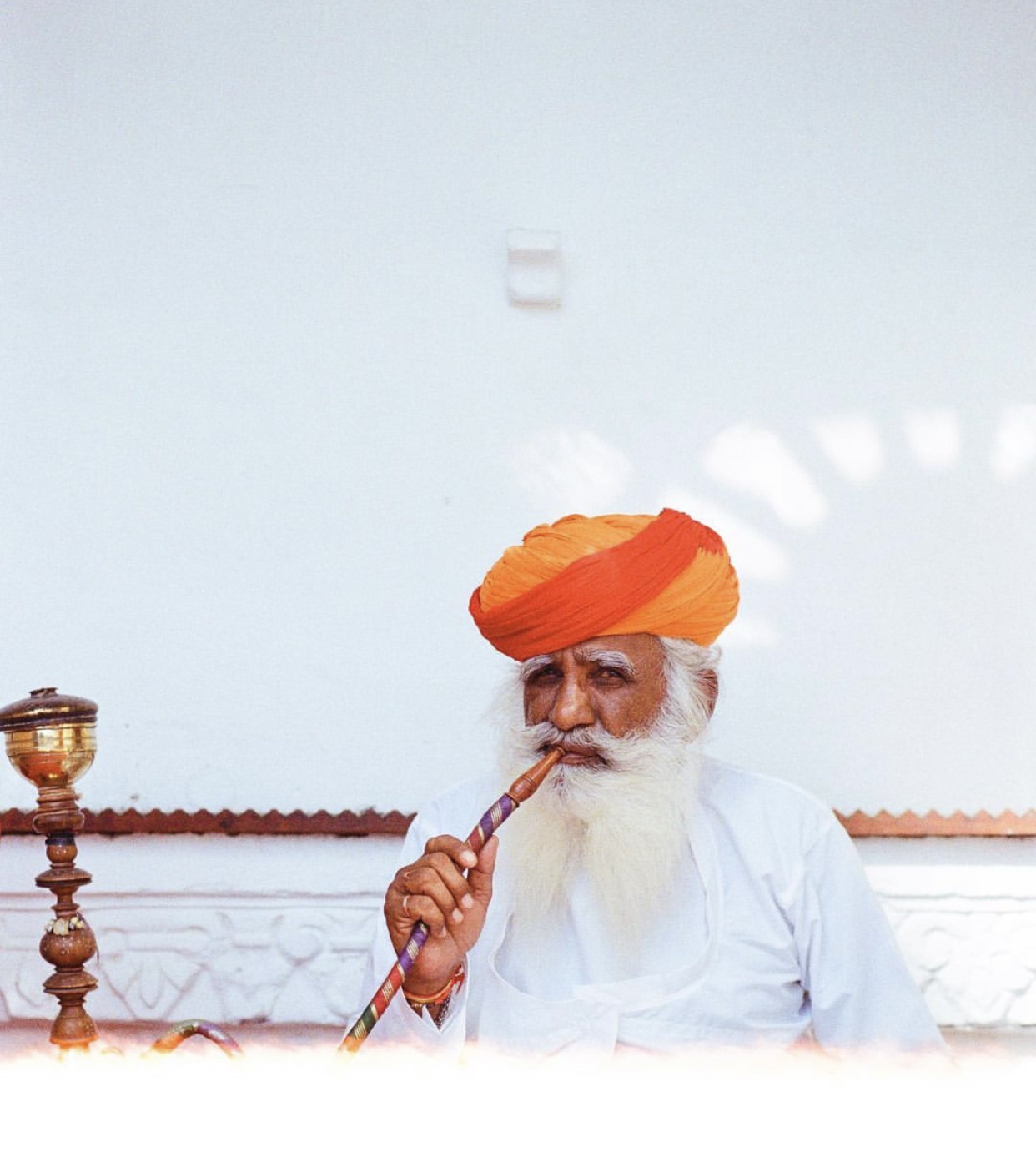

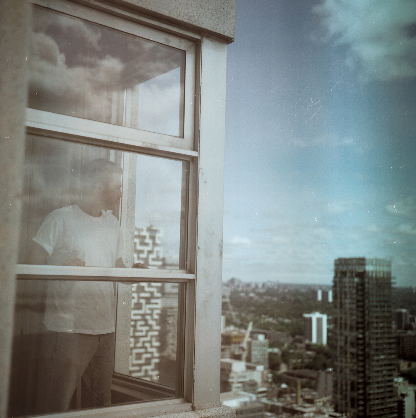

Without seeing the negatives, #1 foreground looks a bit underexposed, but the background is right on, #2 is underexposed and #3 looks on the exposure but color is way off. Something is definitely wrong with the scans of all 3.
P&S cameras can be difficult to control exposure when you have large areas of bright sky like #2. It sees the brightness and make the exposure 1-2 stops less. Some have a "backlight" switch that will bump the exposure, for example, if you have a person in shadow with a bright background.

Thank you so much for your answers and for sharing your thoughts.
After making a one step, auto levels adjustment in Photoshop the contrast came back up.
Thank you for this, it does look much better
I do not have my negatives back yet, as my lab is now shut for the summer but I will post them as soon as I do. The fact that the lab shut right after sending my scans is actually what makes me wonder if they haven't rushed the development... I am hoping the issue is related to the scanning, which would enable me to solve this issue. Is there a possibility something went wrong in development?
Actually, the #2 road picture was shot on my Nikon FM2, not the P&S

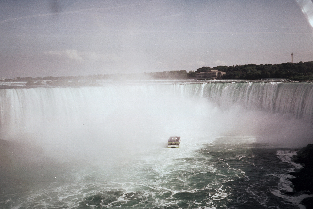

What I haven't mentionned is that all 142 pictures from my 8 rolls have this weird color (not one is decent...) Here are a couple more
View attachment 313188 View attachment 313189 View attachment 313190
#2 looks like it has some vertical banding, but all three look underexposed. As mentioned above please post the negatives when you get them.
And there's dirt and scratches on at least 2 images that aren't likely to be caused by the photographer.
Scanning c41 can be tricky in terms of getting the right color rendition and contrast, partly because of the orange mask and partly because these are artistic decisions rather than absolutes. Having said that, these are pretty abysmal scans. It's hard to tell if the negatives are also wonky.
Are these people running a mini lab or are they doing color processing by hand in something like a Jobo? I'm suspecting the latter given the nature of the dust & scratches. I also wouldn't be surprised if these are flatbed scans from consumer level equipment.
All this doesn't bode too well for the quality of this lab, but it's very possible that additional problems are also present, such as poor exposure/metering and perhaps a camera light leak.

Your photos certainly are nice, but as such, they do not prove that your exposures are consistent; there is still a possibility that some of your frames were underexposed. Your first and second image of this thread do suggest significant underexposure, even if additional problems were present in development and scanning. Don't beat yourself up over it; we all miss a beat sometimes!
PS: the first image of your set of three 'known good' images looks like it also might have been underexposed, but salvaged in digital post processing, possibly without you being aware of it.
In any case, I would strongly recommend finding a way to scan or digitize your negatives yourself, or even start printing optically onto RA4 paper. For one, it effectively closes the feedback loop between exposure and end result, which enables you to learn and improve more efficiently. It might save you some money in the long run, and being better in control of the end result might enable you to surpass the quality you're used to even from a decent lab. More importantly, it's lots of fun!
I see what you mean for 1. I like the desaturated look of 2 but I accept that is only my opinion and others may prefer the increased saturation. What makes the colours way off for 3? Again it has a desaturated look but other than that why are the colours off?
Magenta cast in the center, lighter part of the image, blue cast along the darker edges. So different color casts depending on density, and a gradient density varying across the image surface. And as you noted, saturation issues. If you analyze those images closely, it's really a litany of defects and major problems.

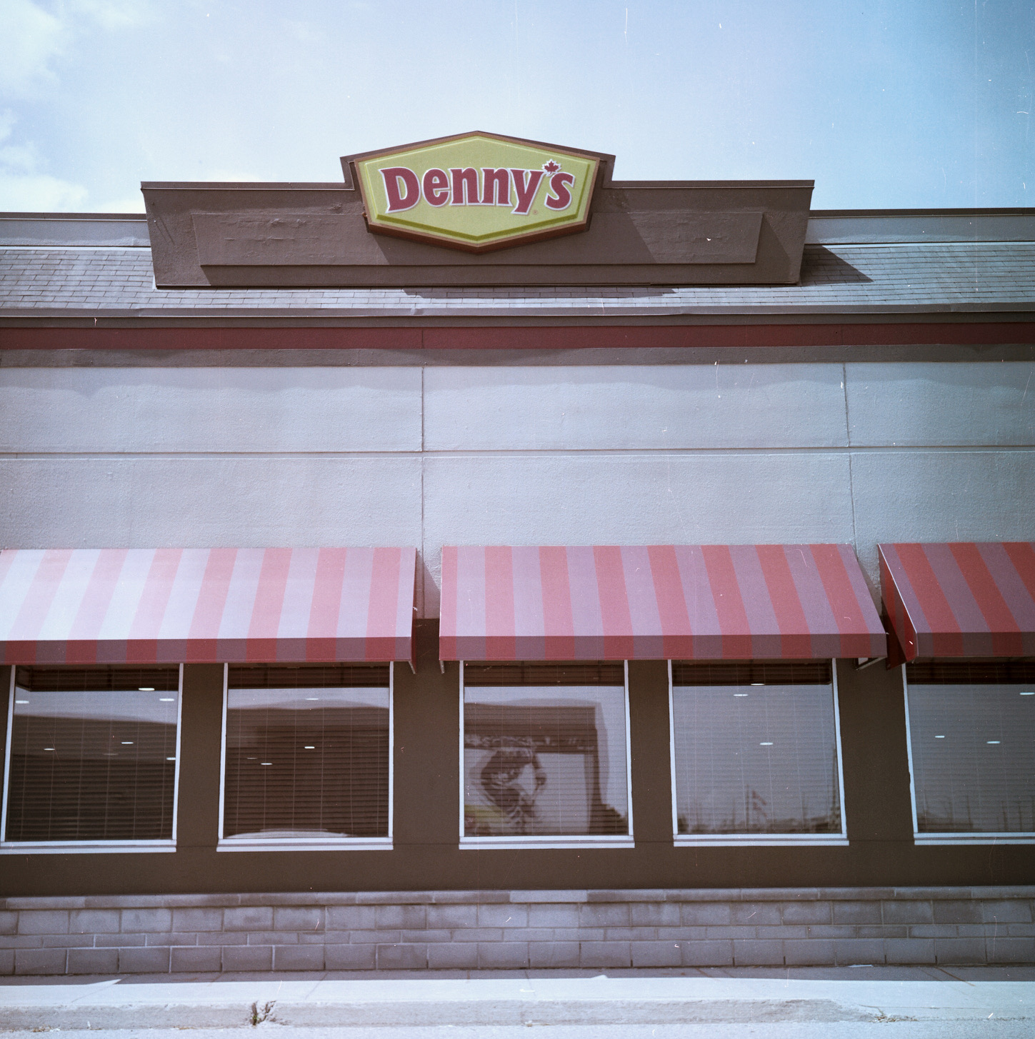

I presume that pic 2 for instance doesn't belong to the same film as pic 3 which is Denny's or if it does, can crossover arise in one frame but not in another from the same film and processing?
