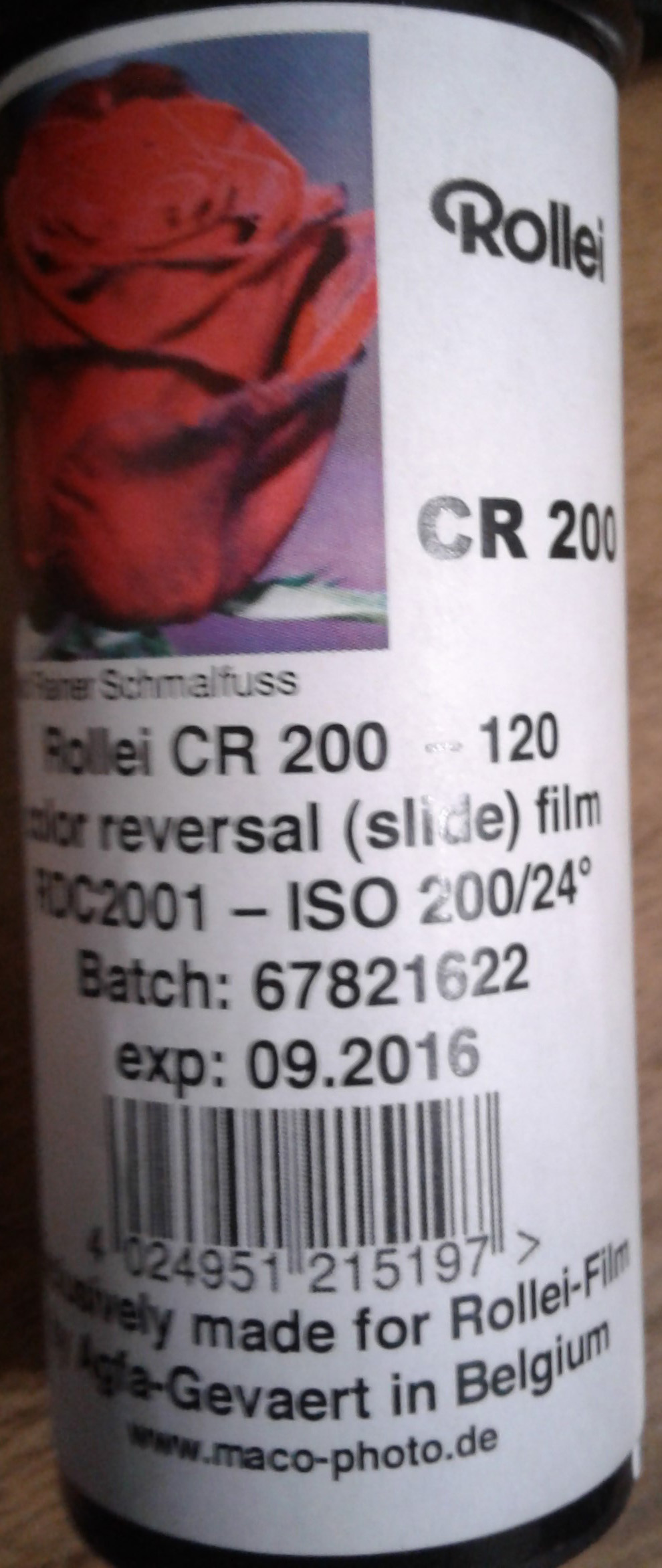

I have never cross-processed film before, but I suspect that is what I did today. I knew that Rollei CR200 has a reputation of a warm yellowish cast to it, but I obtained a deep orange cast -- much like the mask of colour negative film. The film was 3 months expired when I processed it today. When I bought the film, it was about 6 months before its expiration date, but I had kept it in the fridge before I shot it and I kept it in the deep freeze after I shot it, so I can't imagine the "post-expiration" effect could be this severe. The film was labelled on the canister like this, clearly indicating that it is reversal/slide film:

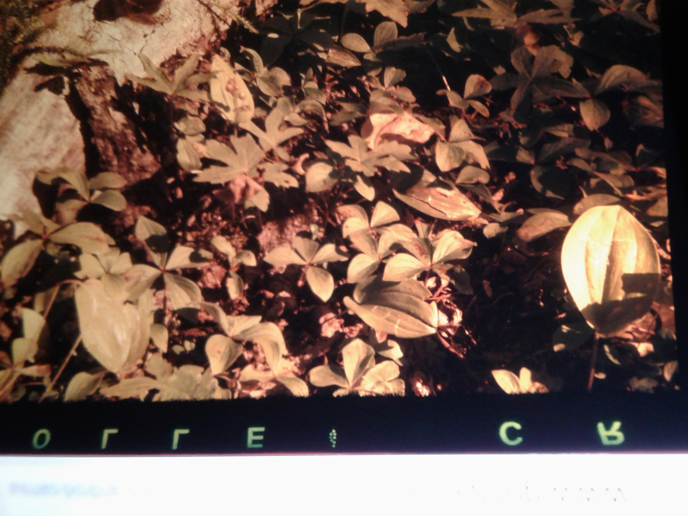

The rebate likewise confirms that this was CR200, not CN200:

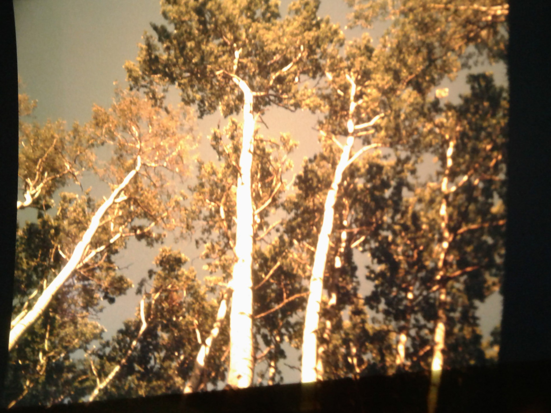

What went wrong? I thought I got a good deal on this film, but now I know that it was false economy. Next time I'm sticking with Fuji (and Ektachrome if it makes it to medium format). This is as blue as the sky got:

that looks about right. if you shoot it when its really fresh it looks ok, but wait a while and thats what you will get. avoid it and shoot some fuji to get normal results.

The is the correct colour for this film. It is Aviphot rebranded as CR 200 and the reddish appearance is typical of aerial photography films. I am not a Lomo fan by any stretch and this colour rendition was too far "out there" for my liking, and didn't imove much in post. So I gave away 2 rolls to a friend who is a Lomo fan!
