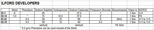

Both of these sentences are counter to everything I've read and also to my own experience. I've generally used benzotriazole with phenidone because it's less responsive to KBR (though I may use that too), and I always get cooler tones with PQ developers on warmtone papers. Having said that I'm no chemist and won't argue wihether the cooler tone is more from the P or the BZAT but I will argue that its there.
This is the difference between Ilford ID-62 -a PQ Universal Neutral tone developer and Ilford ID-78 - a warm tone developer once sold in powder form, it's the basis of the current Ilford warm tone developer. As you can see ID-62 uses Bromide and Benzotriazole while the warm-tone developer only has Bromide. (I spent a few years working as a photo-chemist).
ID-3 is a Soft working developers similar to Selectol Soft/Adaptol, ID-14 is a contrast developer, I used to keep both on the shelf when I used Graded papers.
Ian
Ian
I've used a variant of ID-62 with glycin extensively, and it gives cooler tones than similar MQ developers. That's why I use it.
