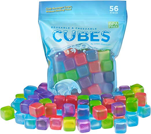

Use Ice cubes from refrigerator, they won't dilute much your chem, You also may use reusable Ice cubes to not add any water:

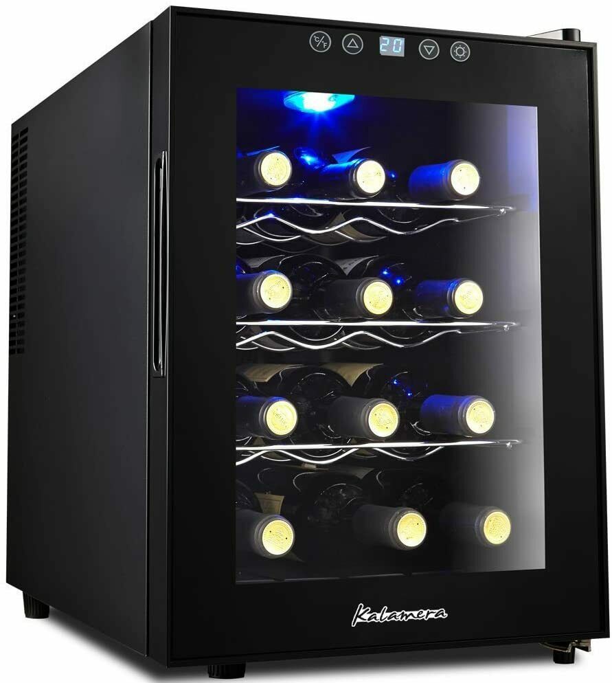

Another convenient way is purchasing a (perhaps used, $50) wine refrigerator, quite convenient, you open the door and chem is at the right temperature without doing anything, if wanting to dilute developer then you may keep also some water inside.
