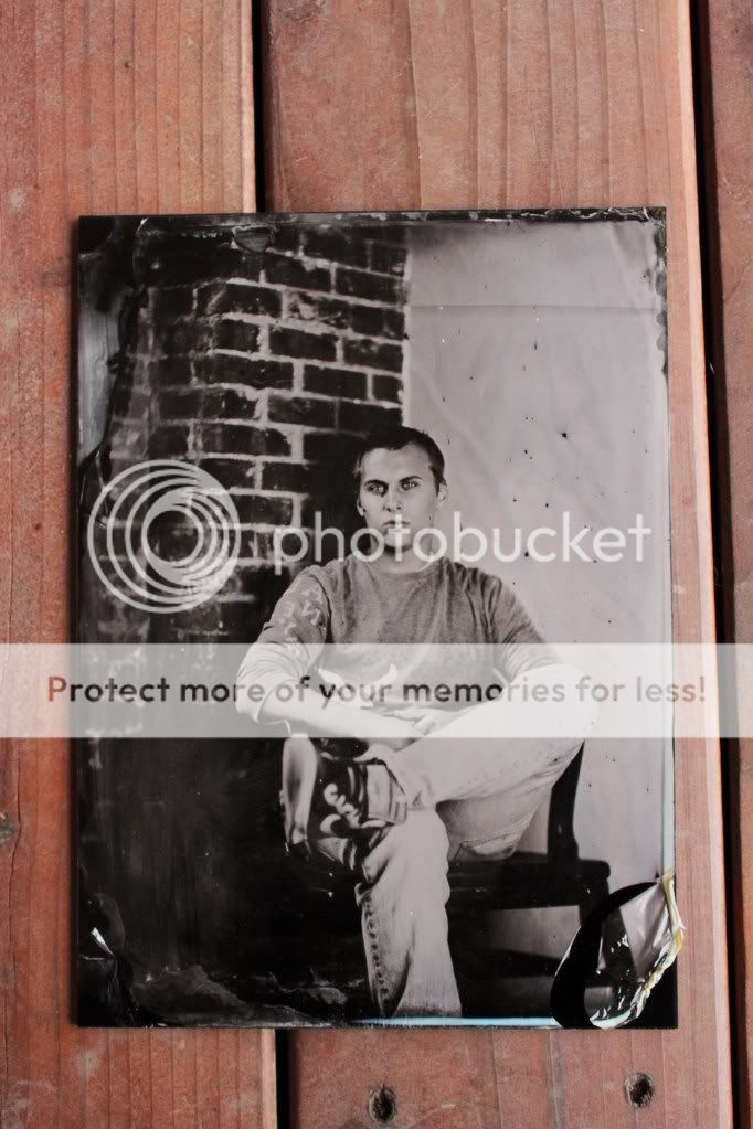

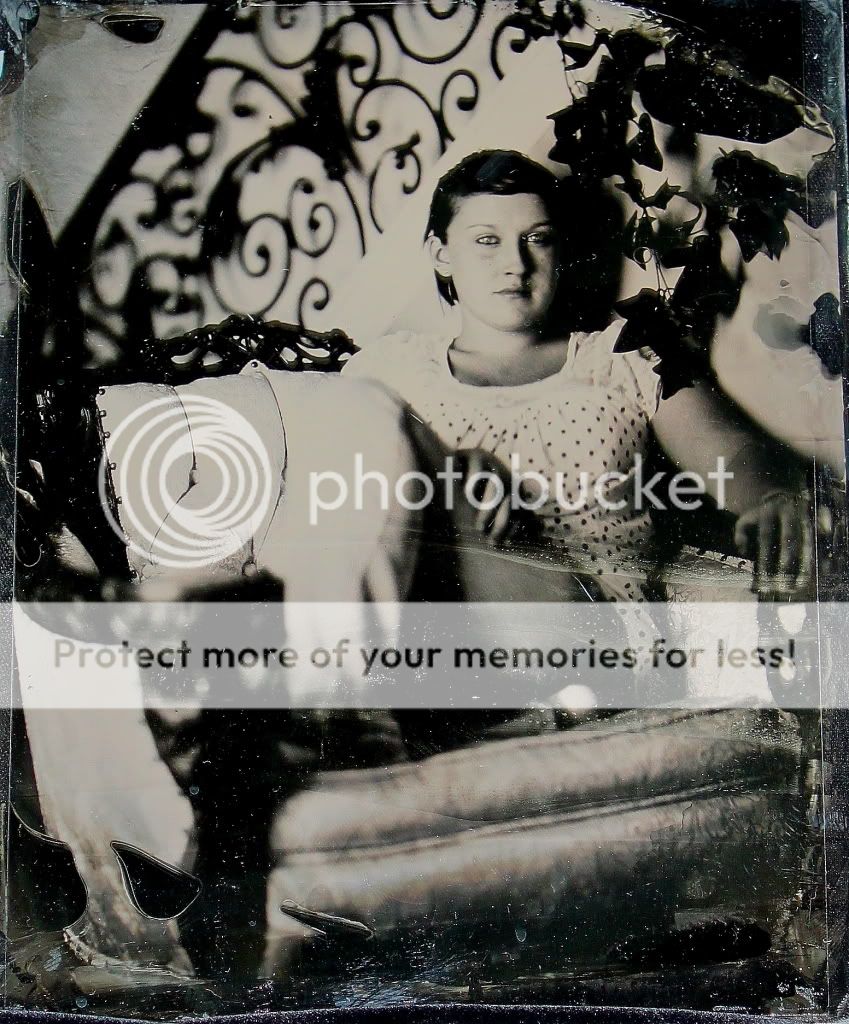

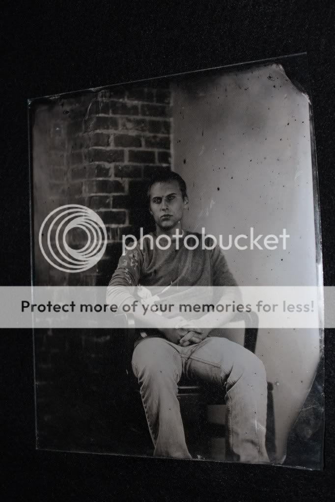

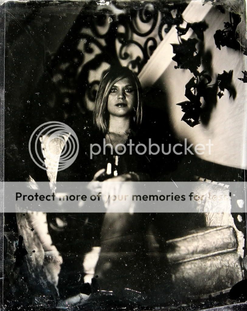

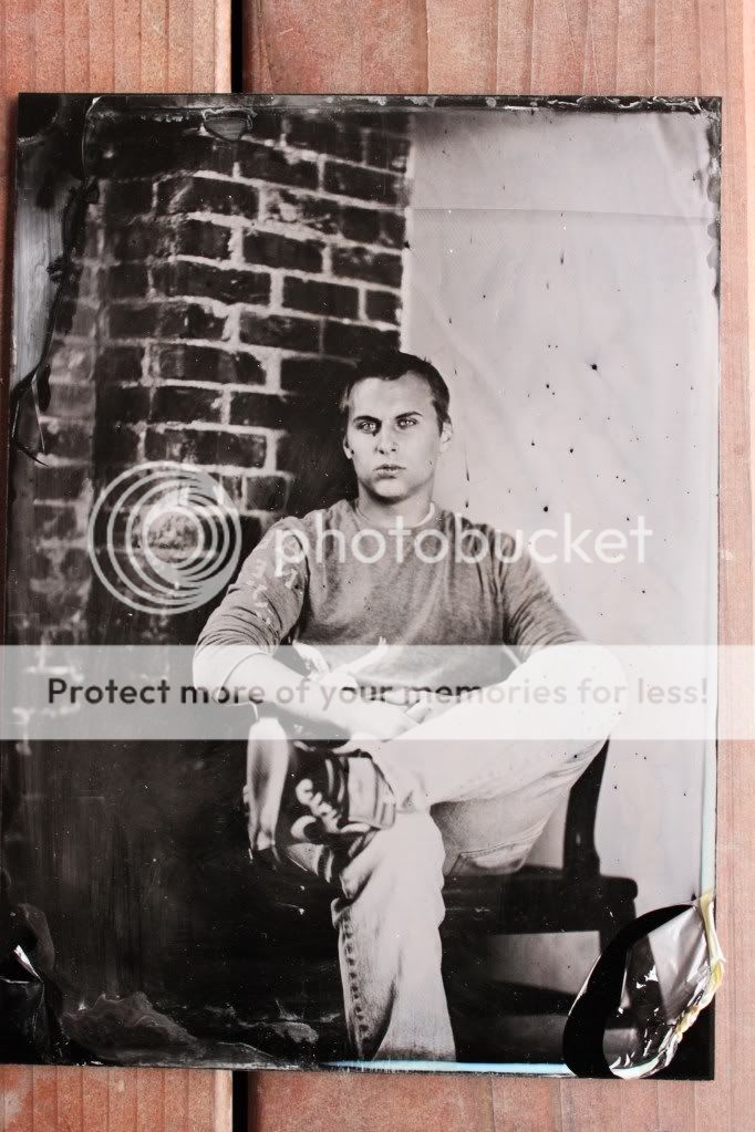

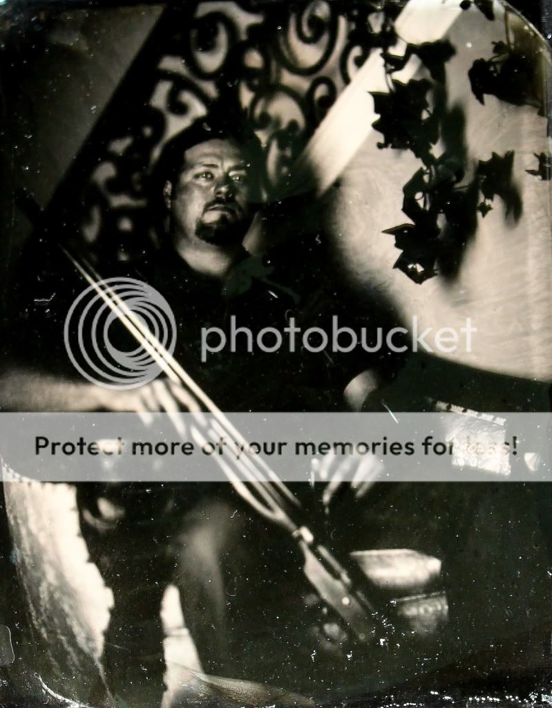

I started with wet-plate, shot about 10 on Christmas, this takes very little room, some use the inside and back area of a mini van. Im doing mainly 8x10 and work in an area thats 8'x8' but only using about 5'-6' for the work area. I highly recommend an exhaust fan as a must which I installed. For now Im using a simple 25 watt red party bulb and its working great for Collodian Wet-plate. I bought a closeout utility sink from HomeDepot and ran some ABS to a floordrain ( didnt even glue it) and this works really well. So Far I have $49 invested in my darkroom including trays I bought used from a photography store and washed them good with alcohol. Im moving on to Ziatypes experimenting and then to Platinum hopefully so I will expand to the full 8'x8' room. with an enlarger my guess is you need atleast the size of the enlarger plus add up all your tray sizes (8x10,11x14 etc) heres my very first attempt using my 1900 Century studio and wetplate, they are taken with a flash, dusty, and on the back of a piece of black glass with a collodian negative on the opposite side so the quality is pretty bad compared to the finished product which I no longer have to take pics of

Mark, one place to get B&W 127 film is a supporter of this site, Freestyle photo supplies in Los Angeles. It is not a very popular film size, and Freestyle only has it in B&W ASA 100 speed. You can develop this film using an adjustable plastic reel in a daylight tank using standard film developing chemicals like Kodak D76. To make enlargments, finding a negative carrier might be difficult as the film is 4cm X 4cm square. You can use a 645 or 6X6 neg carrier and mask off part of it to fit the 127 film size.
Your wet plate photos turned out quite nice. Looks like you have gotten bit by the photobug.
