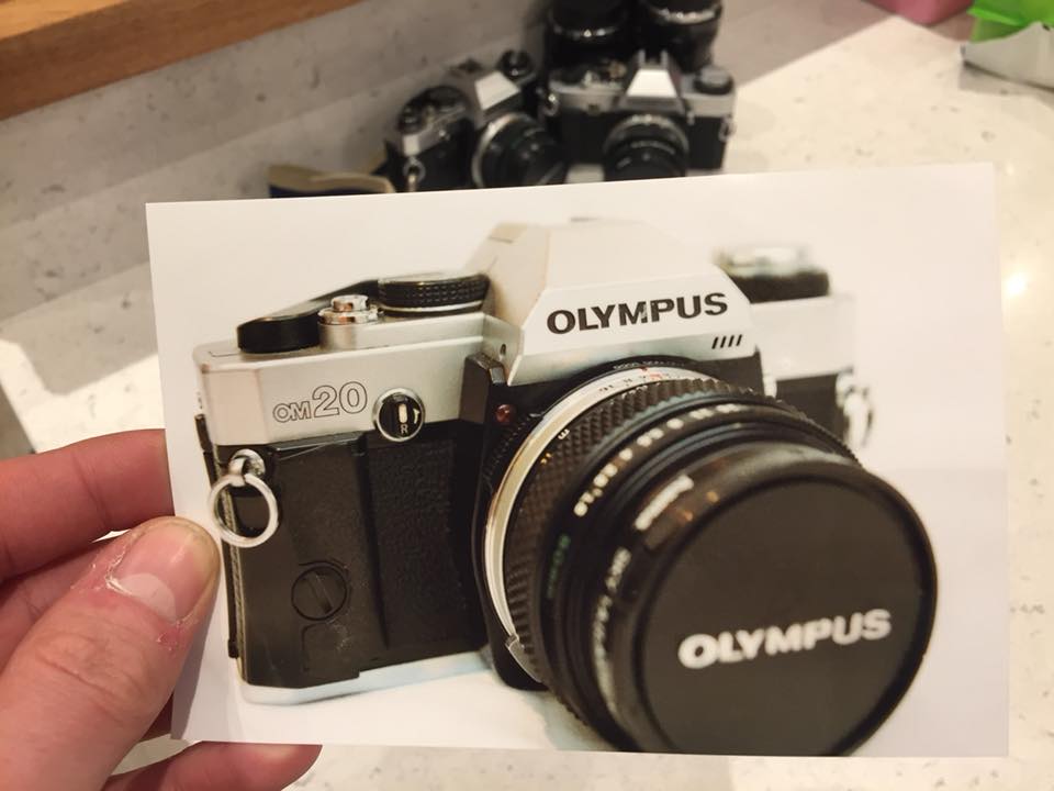

Well I have tried them out and they all seem to work well!! I shot two rolls...one of a few things round the house, and one roll during a trip in London . Results were pleasing. Attached is one taken with the Miranda/Corsina lens....its the best photo of the bunch! Interestingly, the film was AGFA 200 that had an expirary of 2006! It was in a box in my Dads bedroom, so I shot it at ISO100 and one of the shots is below.
