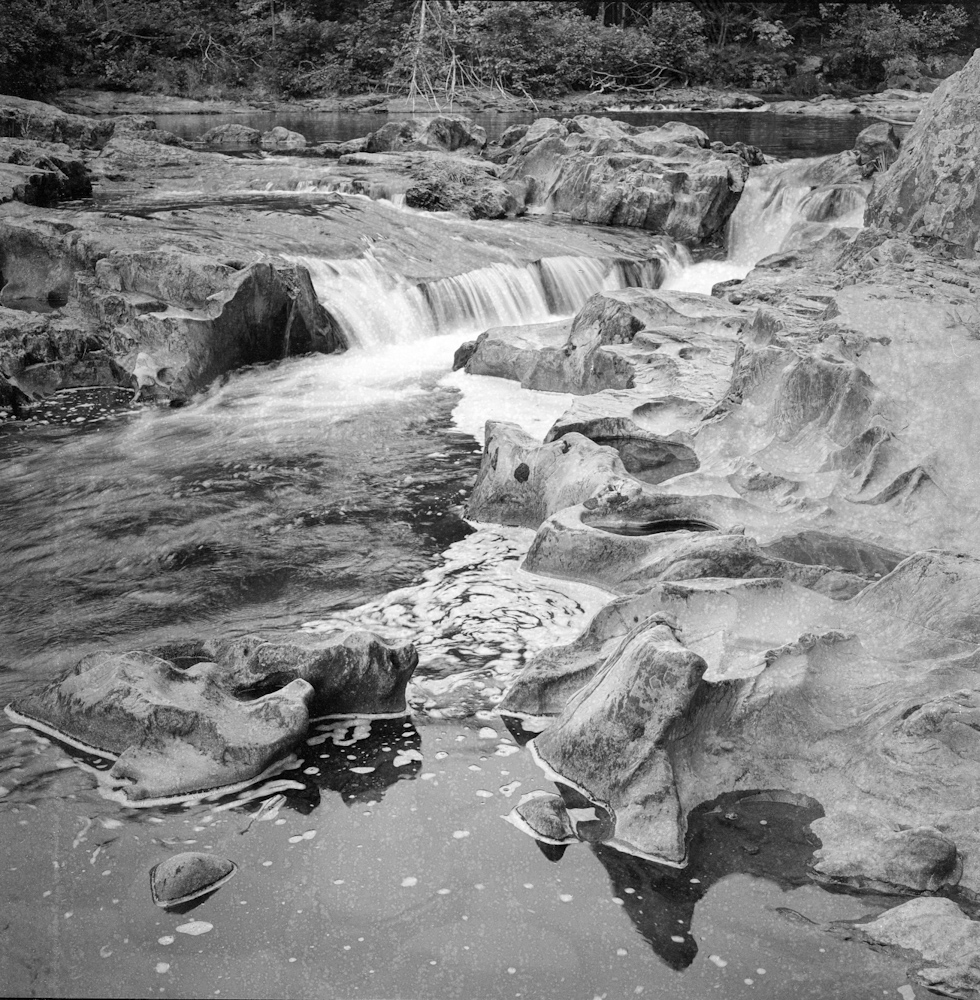

I just developed this roll a couple of days ago. It was shot a couple of years ago, and I can’t easily go back and reshoot. The mottling problems can’t be remedied by a free roll of film.

looking back last night at some rolls I shot in 2019, there's one roll of FP4+ which exhibits a little mottling which I hadn't taken notice of before. It's "just" holiday photos so I wasn't especially critical of the outcome. But that would have been within date when I shot it. Probably from the time when Ilford had issues.
I would think that the specific batches from those times which are known to have problems should be avoided for anything like serious photos even if fridged/frozen.
For films manufactured since the problems have been solved, I'd still advise some caution but I've been shooting Delta 3200 this year which expired in February 2024 and was frozen until September 2024 without any problems. Decided to use it up before it hit 12 months over it's date. I even pushed one roll to 12,800.
