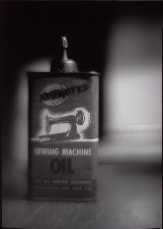

Here's some results from a 6" magic lantern lens on 5x7. Paper negatives btw,
I wouldn't recommend using a 4x5 sized Rapid Rectilinear, it will be unpleasantly sharp on 5x7. Or at least mine was.

Just completed developing 6 negs with that little lens. It certainly has a look all it's own. It focuses at about 4" so it may be wider than what your friend wants. I'll do some scans later and come up with a price. The scans will give a good idea of exactly what to expect.
