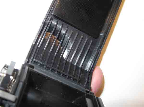

-Camera Back cover, plastic.

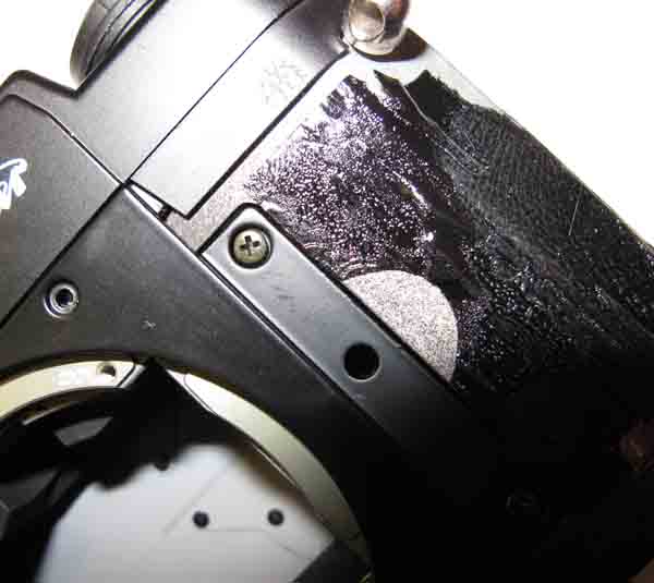

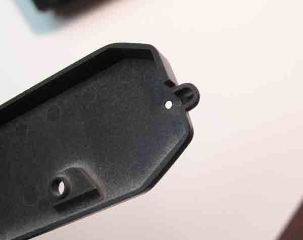

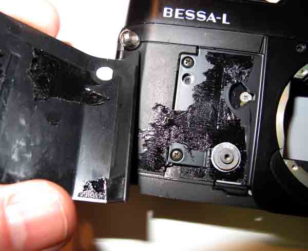

Bessa L innards, so far:
Remove plastic front covers by gingerly lifting away from double sided tape.

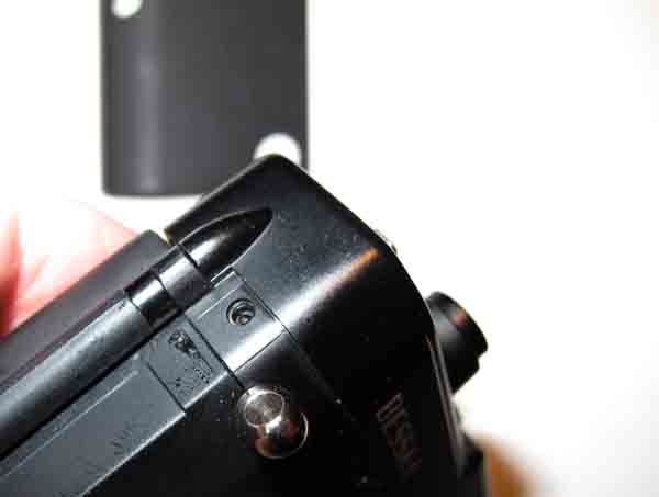

Screws on top both sides remove.
Remove screws on front bezel

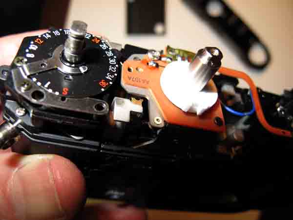

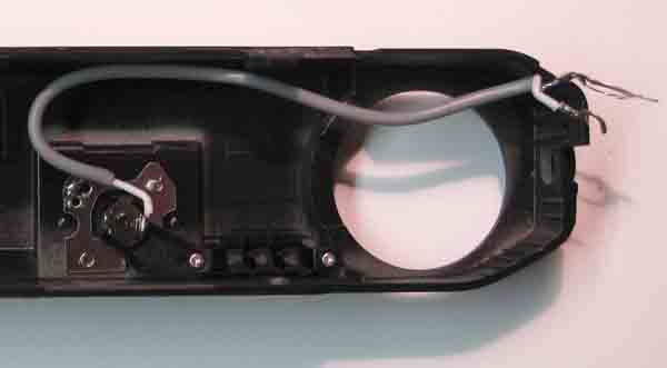

Innards for meter and flash. Lotsa plastic and tin.
Plastic top and really wretched flash connections.

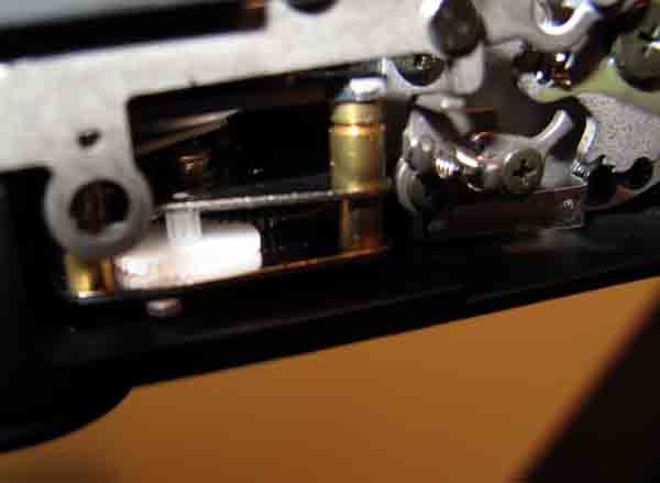

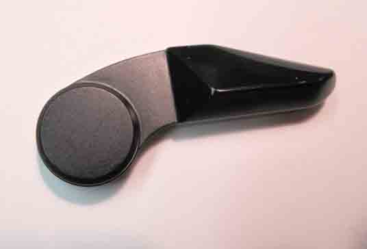

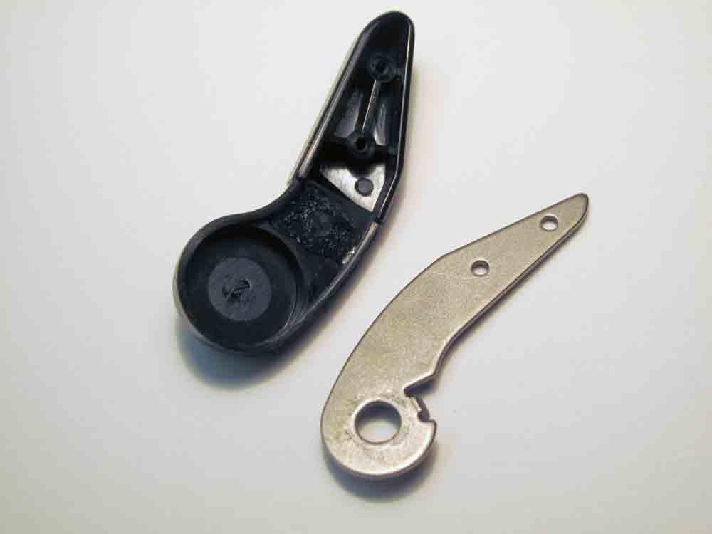

From the top the winder looks great.
To remove winder remove two screws underneath to reveal a rather tinny cheap mechanism.
