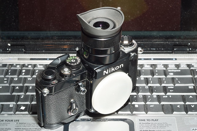

The Nikon F2 has a magnified "WLF" that you view by looking down, but you'll need to hold it to your eye for viewing. I have one and like it. Even with 6x6 I don't often hold the camera at waist level, I flip up the magnifier and hold it to my eye.

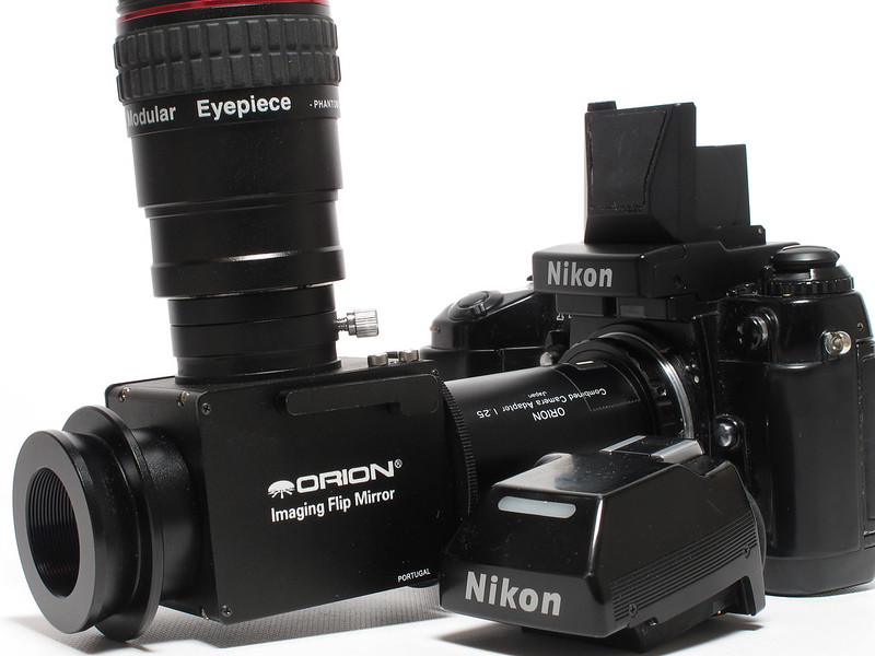

Since I need to attach my cameras to microscopes and telescopes, a waist level finder has been an important feature for me for a very long time. My first SLR, a Miranda Sensorex, had an interchangeable view finder. Since the Sensorex, I have used the Nikon F, F2, F3, and F4 which all had interchangeable view finders which included a waist level finder.
Here is my Nikon F4 with a DW-20 waist-level finder that replaces the eye-level finder.
Nikon F4 with waist-level finder by Narsuitus, on Flickr

If you have to bring your eye to it, a right-angle finder attached to any prism-finder should do the same and even be more versatile.
For close-ups, macrophotography, astrophotography, I have tried the right-angle finder and the Nikon DW-2 6x magnifier finder and have had better fine focusing success with the magnifier finder.
Nikon F2 by Narsuitus, on Flickr
