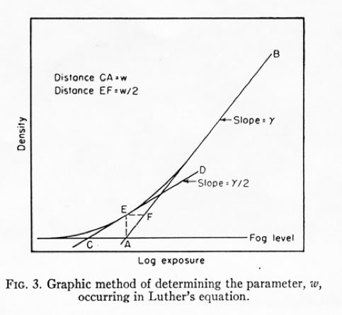

Yes, when I first got the paper from you I discounted that 'w' method pretty quickly! But, after researching all the "inertia" papers, I came back to the W-speed. After reading the chapter a few times I realized all the difficult math from the Lutherian Equation Curve Fit was already done and incorporated into the final equation in the paper:
Difference between 0.3G and "Inertia" = -0.0948 + 0.0122w - 2.2945 w(squared)
So, all one needs to do is get Excel to figure out the 'w' term and plug it in.
The components of 'w' are gamma, inertia and 'E.' The gamma and inertia I'm already getting but the "E" has to be read from the graph. My solution was to get Excel to automatically get the "E" value with a clever use of IF(AND( ,),,) statement running down the column of values.
"A" in the diagram is the same as the "Inertia" point of H&D.
From the paper. The "w" term I calculated as "C" minus "A" where "A" is the X-intercept of the straight line and C is calculated by geometry from point "E" and one half the slope of the straight part. For practical reasons I use a simple 'two point geometric interpolation' to get E from my data, rather than some extensive curve fit.

Would you mind going over the spreadsheet in detail?
"E" is defined as the point where the inertia (X-intercept) would intersect the toe of the curve if a straight vertical line were drawn up from the inertia point.
I make the assumption that there is a straight line between my data points (rather than a curve) this simplifies the math quite a bit.
The spreadsheet locates the two horizontal datapoints between which the inertia lies. It calculates the slope of these two points.
It makes a right triangle (not shown on the graph from the paper). The base is the horizontal distance between the inertia and right datapoint. The slope is calculated above. The unknown vertical segment is then easily calculated (slope = rise over run). So, after calculating this vertical segment, I subtract it from the vertical density of the right hand datapoint and this gives me the unknown vertical density of "E," or the distance E to A on the graph.
If you look at the graph from the paper you will see another right triangle ECA. We know by definition that the unknown "w" is equal to the distance C to A. We know the slope of E to C, which is by definition one-half the gamma. Therefore "w" is equal to "E" over "one-half gamma."
Now that "w" is known, it can be put in the equation from the paper to easily solve for our correction factor that is added to the inertia to get our 0.3G point.

I noticed that this thread (as almost every informational thread I posted since 2007) has lost all the photographs that were hosted on PhotoBucket. I'll try to post some of the images, but it is hard to know what is missing without practically re-doing the entire thread.
Here is one graph from the W-Speed paper, showing how the W parameter is computed from the H&D curve toe.
