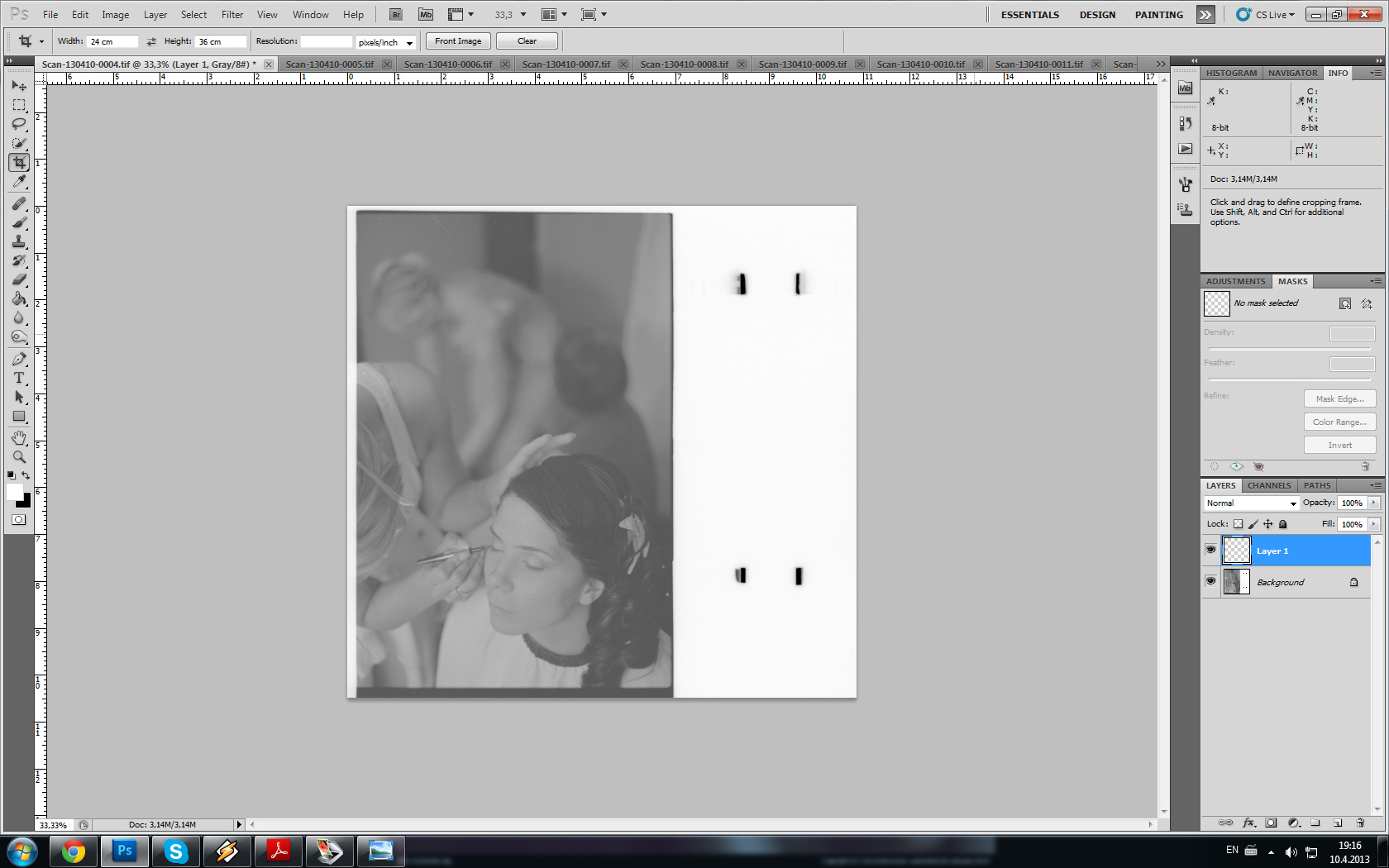

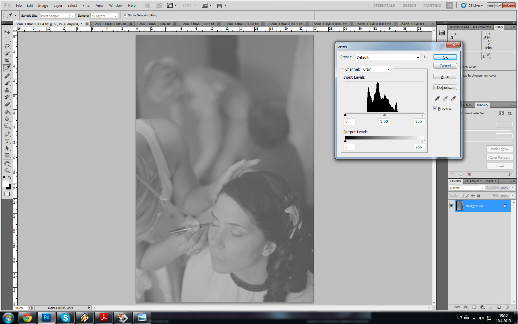

I have downloaded Vuescan 9.2.11 and two problems emerged (for now). First, it doesn't recognize frames so it scans a lot more than that 35mm frame and second (which I think is in correlation with the first one) is that histogram is really off. I can adjust it in PS but it comes with the price of detail loss in both light and dark parts...

Yes, but even when i crop it manually it seems to do what it wants, in other words, my guides are useless because it does what it does. Tried reinstalling the program, maybe download some other version?

Try scanning at 16bit, rgb and output to dng. The histogram you are showing indicates to me that you have captured everything and all that is needed is to adjust the high and low ends, set the density (create a midpoint and move up or down) and contrast (create a quarter point and adjust up or down-- opposite the density for more contrast in the same direction of density for less). I would use the curve tool over the histogram tool. When you are done if you've scanned it as 8bit or only grey than your histogram will look like a comb (the comb of death), but this has less to do with vuescan than it does with the scanner and mostly the scanned bit depth.
